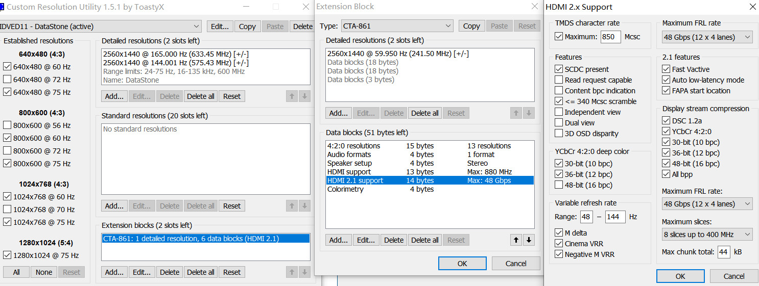

(10-05-2022 09:08 AM)simon52min Wrote: What i 'd like to do is connect a virtual display device through the hdmi interface of the 3070 graphics card, to create a virtual desktop of 2560 * 1440 @ 165Hz, or 3440 * 1441 @ 144HzYou need HDMI 2.1 with FRL for those resolutions. All the emulators I know only do HDMI 2.0. |

(10-06-2022 02:21 PM)ToastyX Wrote:(10-05-2022 09:08 AM)simon52min Wrote: What i 'd like to do is connect a virtual display device through the hdmi interface of the 3070 graphics card, to create a virtual desktop of 2560 * 1440 @ 165Hz, or 3440 * 1441 @ 144HzYou need HDMI 2.1 with FRL for those resolutions. All the emulators I know only do HDMI 2.0. Can you tell me in detail what is the difference between the HDMI 2.1 and the HDMI2.0 emulator? I had added CTA-861 block via cru tool, and add data block hdmi2.1 support. Is there a parameter that is not set correctly? |

(10-08-2022 03:50 AM)simon52min Wrote: Can you tell me in detail what is the difference between the HDMI 2.1 and the HDMI2.0 emulator? I had added CTA-861 block via cru tool, and add data block hdmi2.1 support. Is there a parameter that is not set correctly?You can't add FRL support with CRU. The device has to support it. HDMI 2.0 is limited to 600 MHz pixel clock. |
