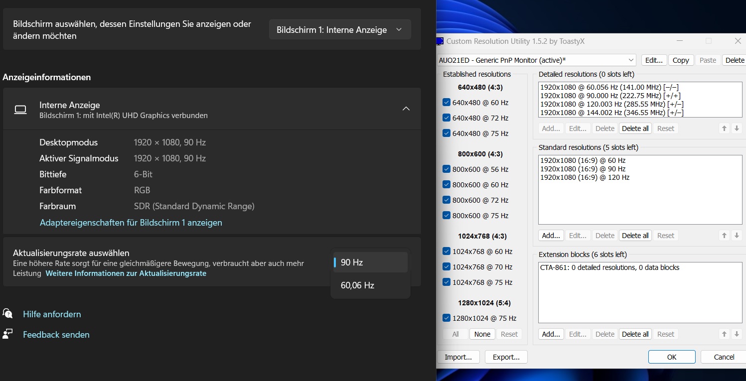

i got a little problem right here with my laptop. I tried to add more 1080p resolutions to the settings but it only shows up the 90hz and not the other 120 or 144hz.
Original it´s an 1080p 60hz display, working flawless under 90hz so far with no problems Smile
im just curious now why i cannot add 120 or 144hz? Even if i try to add 70hz or 100hz it doesnt show up.
Any solutions?
thx in advance Angel

(11-29-2022 11:55 PM)patrickge Wrote:  i got a little problem right here with my laptop. I tried to add more 1080p resolutions to the settings but it only shows up the 90hz and not the other 120 or 144hz.
The hardware has a limited amount of bandwidth. Your 90 Hz is showing 6-bit color, so there's not even enough bandwidth for 90 Hz with 8-bit color.
it's just an 6bit Panel build in.... this one: https://www.panelook.com/B156HAN02-1-AUO...76737.html
anyway i cant even change to 70 or 80hz for example. weird...
