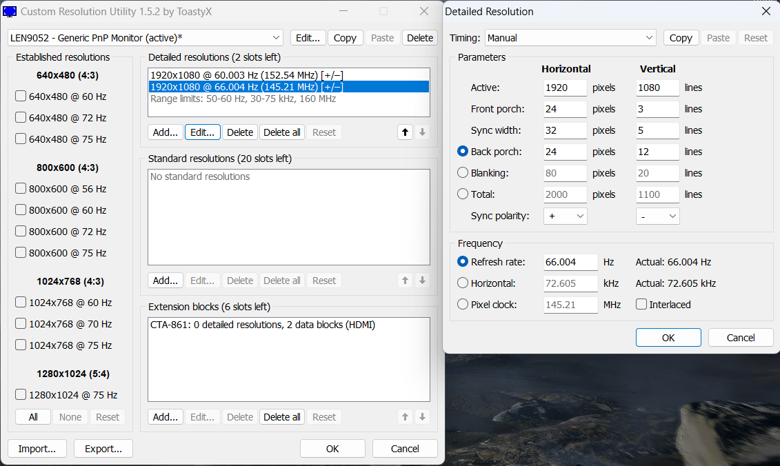

01-25-2023, 04:13 PM
(Last edited: 01-25-2023, 04:14 PM by CroAtTheTop)
Post: #7186
Hey, so I've been trying to reduce horrible ghosting on my 60Hz laptop display (Lenovo 15ACH6), it's so bad that even simple scrolling websites make it "vomit-inducing" while playing games, especially faster paced is nearly impossible.
I've tried to overclock the panel, but only got lucky with Reduced reaching 66Hz, it seems the pixel clock rate is at its maximum with 153MHz, no luck with enabling VRR either. Is there anything else CRU-wise I could try? At least to get VRR enabled or anything else that would further reduce the ghosting. Thanks! |

(01-25-2023 04:13 PM)CroAtTheTop Wrote: Hey, so I've been trying to reduce horrible ghosting on my 60Hz laptop display (Lenovo 15ACH6), it's so bad that even simple scrolling websites make it "vomit-inducing" while playing games, especially faster paced is nearly impossible.There's nothing that will make a bad panel magically better. VRR is not going to reduce ghosting, and it's not possible to add VRR on a laptop screen except on some laptops with AMD GPUs by adding a FreeSync data block in a CTA-861 extension block. |
