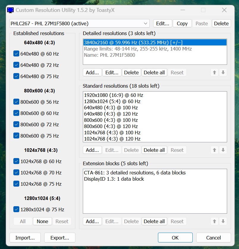

I'm having a problem with my Philips 27M1F5800. The monitor is capable of outputting 3840x2160 @ 144Hz, 120Hz, etc... but I can only find 3840x2160 @ 60Hz, and then a load of lower resolutions at 100Hz and 120Hz etc. I cannot find 3840x2160 @ 144Hz or 120Hz anywhere.
Can someone help me find the resolutions I see in Windows?
The GPU is a 4090
https://i.ibb.co/6sY087x/Screenshot-1.jpg
https://i.ibb.co/n1rhZSz/Screenshot-3.jpg

(03-09-2023 05:21 PM)Waldo Wrote:  I'm having a problem with my Philips 27M1F5800. The monitor is capable of outputting 3840x2160 @ 144Hz, 120Hz, etc... but I can only find 3840x2160 @ 60Hz, and then a load of lower resolutions at 100Hz and 120Hz etc. I cannot find 3840x2160 @ 144Hz or 120Hz anywhere.
They're in the DisplayID extension block.

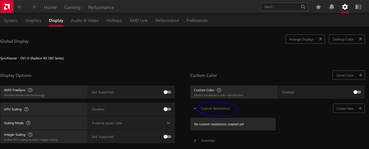

is there a way to save and load custom resolutions of the amd driver? without driver restart
