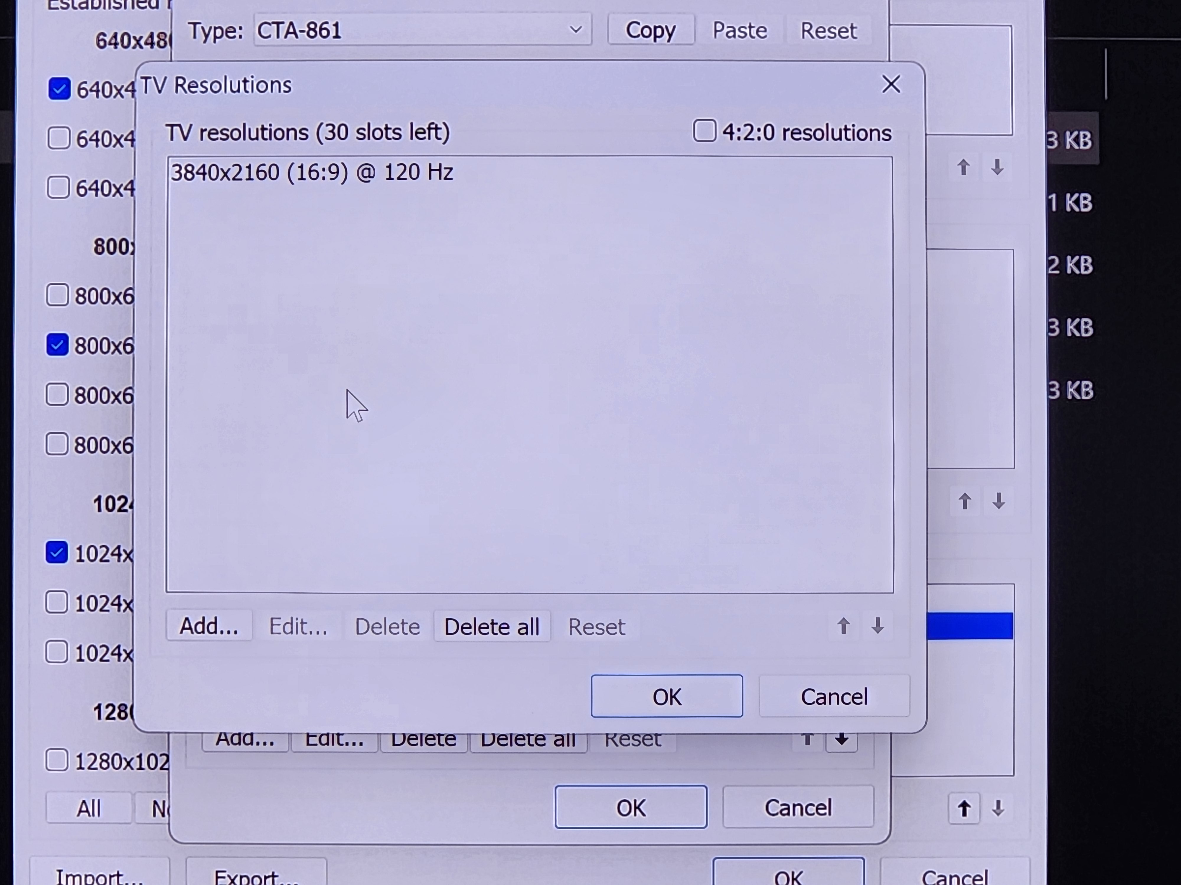

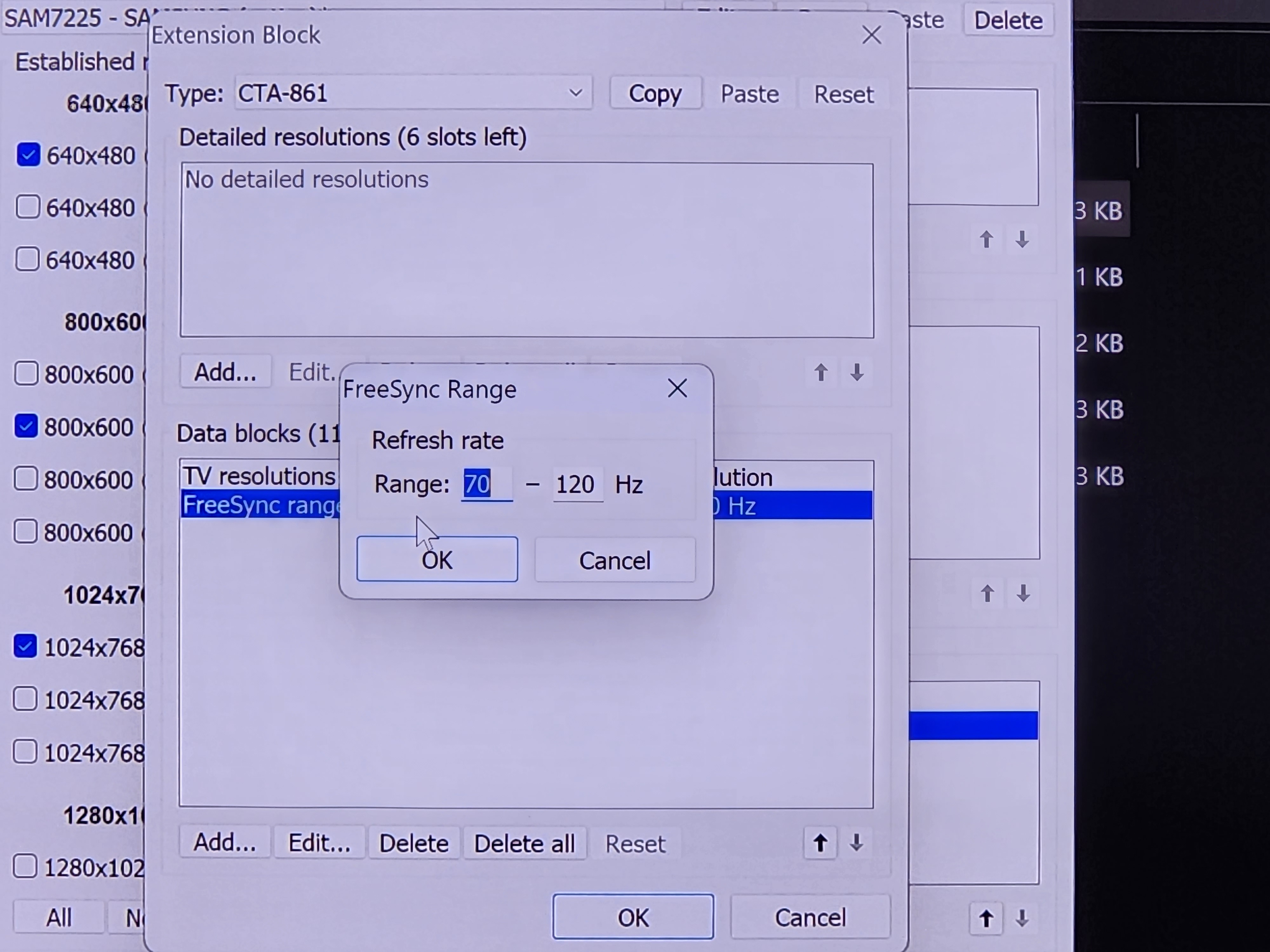

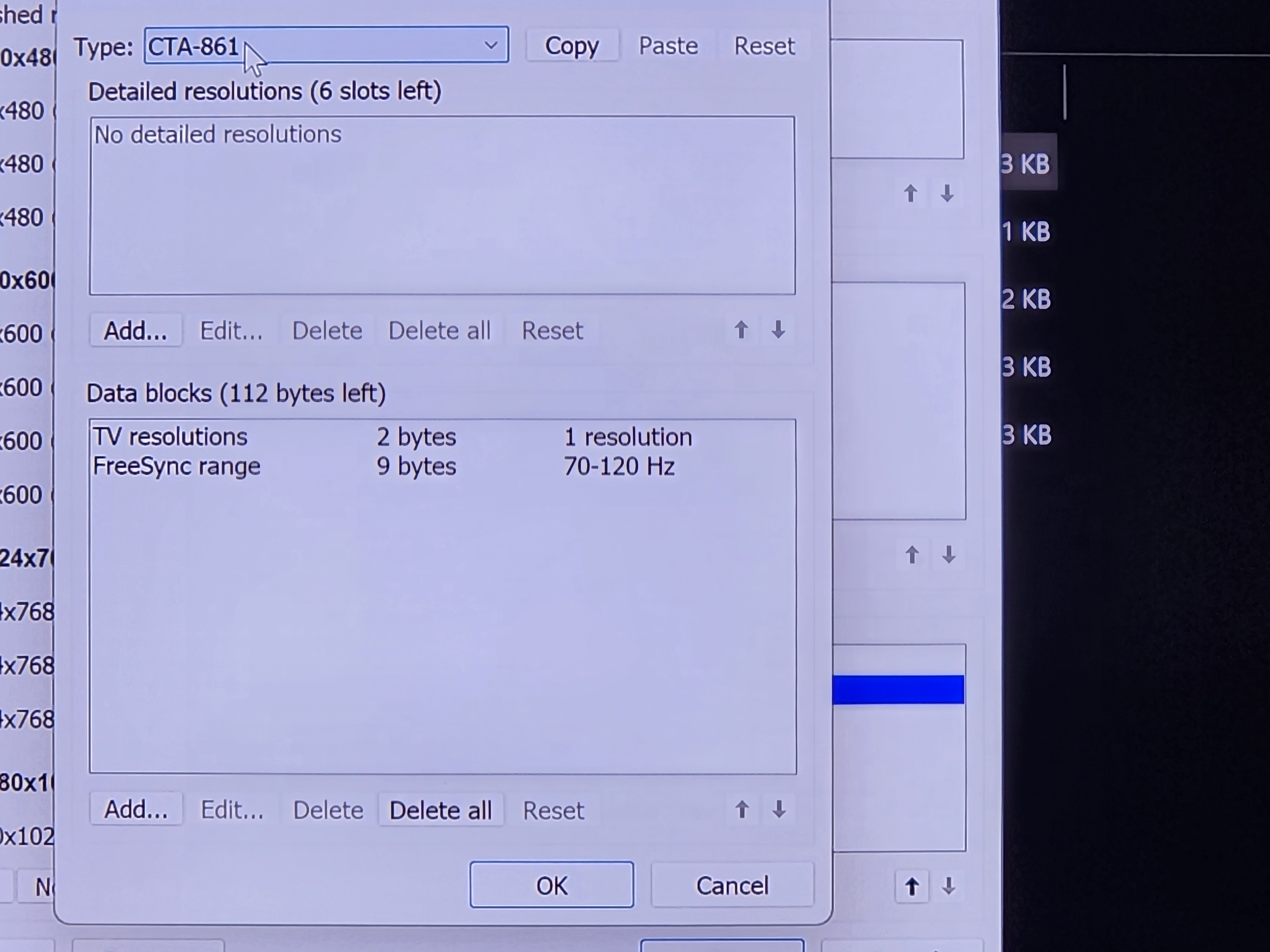

05-06-2023, 06:56 PM (Last edited: 05-06-2023, 07:14 PM by Travis5151)
Post: #7396
I am having a difficult time figuring out how to use this to resolve flickering/stroking with freesyns (nvidia gsync enabled) and my Sansung 800b tv (connect hdmi 2.1 through Yamaha a2a receiver) and was hoping I could get some help.
In windows I have 4k 120 selected and it works great without gync enabled. Once I enable it in some games I get the brightness flicker. I have loaded cru and added the below as picture
Am I doing it right? How do I apply it? I did reset 64 but in game I don't see a difference and I am unsure how to verify it. I added the resolutions in the cta 861 block as the detailed resolution area won't let me chooseb120 hz. It goes red.

(05-06-2023 06:56 PM)Travis5151 Wrote:  Hello,
You would need to edit the VRR range in the HDMI 2.x data block in the existing CTA-861 extension block, not create a new extension block. NVIDIA does not use the FreeSync data block.
Thank you for the reply but the existing block only show 60 hz. How do I get ti to show the 120 I am using?
As an additional bit of information I narrowed it down to having hdr enabled. With it off the brightness flicker seems to go away. Also if I connect pc to tv then it goes away even with hdr enabled but the samsung does not output atmos to my receiver for some reason so I can't do this.
