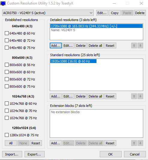

Post: #7762
Specs:
1660 Super
16 gb ram
AMD ryzen 3700
b450m BAZOOKA MAX
Monitor: Nitro VG240Y S Widescreen Gaming LCD Monitor
I have display scaling and gpu scaling. Before clicking restart64
I have display scaling, however, after it changes to GPU scaling.
im trying to lower the resolution, not increase.
Any help/solutions is much appreciated
[attachment=1291]

(11-19-2023 10:52 PM)BreadedToast Wrote:  I have display scaling and gpu scaling. Before clicking restart64
You changed the native resolution to 1720x1080, and you have no lower resolutions to scale. The native resolution is already sent to the display regardless of the GPU scaling setting. You can verify this in the monitor's menus. It should report the resolution it's receiving somewhere.
