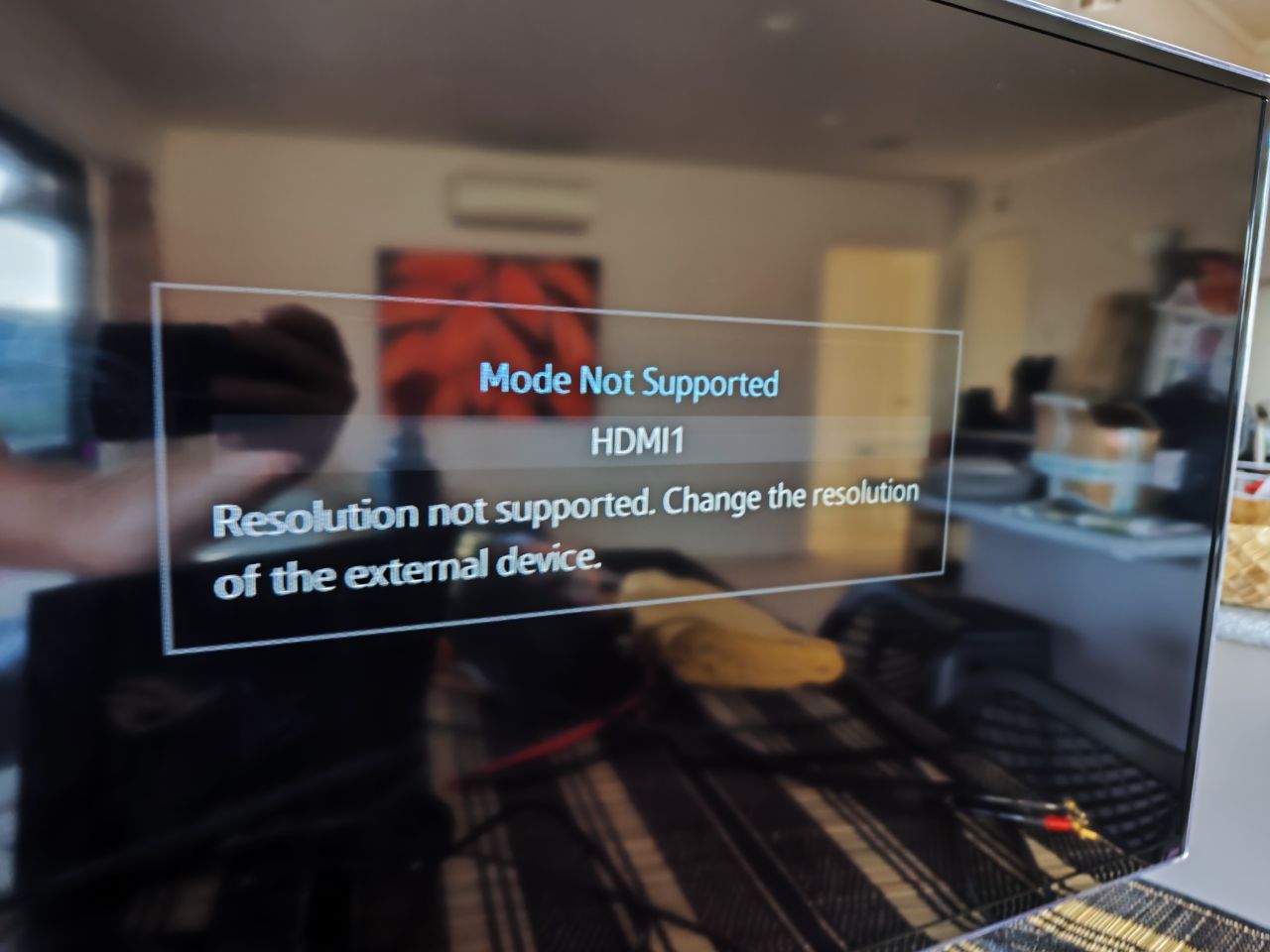

(11-29-2023 02:55 PM)ToastyX Wrote:
(11-29-2023 10:58 AM)Shaunuss Wrote:  Thanks man I created a detailed resolution, I also created a standard resolution. I even tried adding one in under extension blocks as a TV resolution. None of it works.
Please see my test.txt attached.
My display adapter is AMD Radeon RX 6800M
This is documented in the first post: AMD/ATI's driver also listens to the maximum TMDS clock in the "HDMI support" data block (in the CTA-861 extension block). Make sure it's enabled and set to 340 MHz.
Thanks man! Your info got the resolution selectable in Windows but the TV rejects it. I assume Samsung has their firmware set to say no to any non standard resolutions. I don't see any way around this. Thanks for your help!
