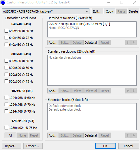

Was wondering if there was any way to fix the PG27AQN or ADA. bc not being able to set a custom res is pissing me off lol

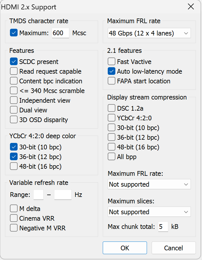

Hi Toasty,
Hoping you can help me disable DSC on my Samsung s90c. My goal is to enable DLDSR on the nvidia control panel which I believe DSC to be the culprit for it not showing up there. This is on a 4090 build.
I have your modified CRU you created for L337Fool that fixed the extension block issue with that panel. So far I've tried unchecking all DSC boxes and checking 'not supported' in that section (see attached image) then restarted graphics drivers, turned off game mode, and switched to 120 Hz. No luck so far, and it also says 'restart required' beside the panel name. Since I don't really know what i'm doing i'll take any further suggestions!

(11-28-2023 12:41 AM)b0utamine Wrote:  Hi Toasty,
P.S. just donated to your Patreon as a token of gratitude for your work Smile
Thanks. NVIDIA's driver is broken and ignores EDID overrides for any display affected by the extension block issue. This needs to be reported to NVIDIA. The modified CRU only lets you read the first extension block and can't work around NVIDIA's issue, so you can't use CRU with the S90C until they fix this.
