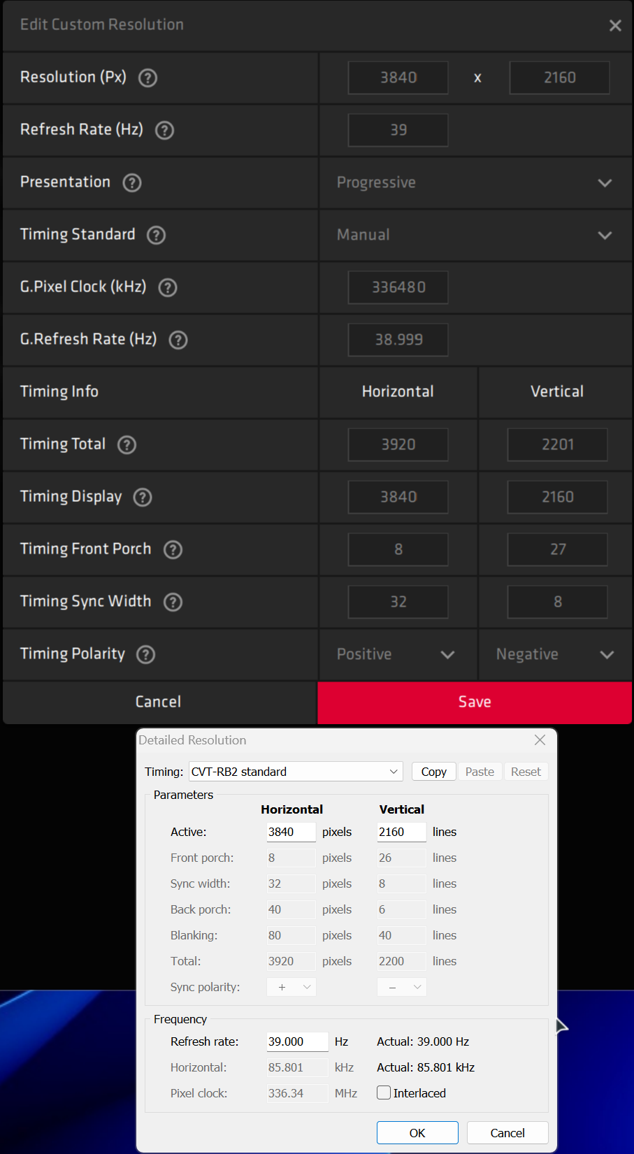

@ToastyX Thank you for your help. I am trying to be as clear as possible. The Voltage reduction because stock melts the memory module thermal pads, stock voltage on r9 290-390-390x is 1.55V, I found I could reduce it down to 0.9V, huge impact on thermals & can now improve the core frequency. It's in game stable.
Anyway, back to the topic of how to achieve 4k60 precisely over Displayport to HDMI 2.0 adapter, with amd radeon r9 290 adrenalin/ 22.6.1 or 23.11.1 drivers & how to get rid of the Interlaced Refresh Rates, and have only Progressive with CRU? How to make it to where when setting 4k60 (3840x2160p 60hz) (What is the desired setting for setting up CRU, Exact or CVT-RB, or Other?) It defaults to 1080i60 instead of 3840x2160p60? Thanks
I can try and video record the symptoms, if it helps. I hope I was clear enough.
It looks like I cannot get more than 340Mhz on 22.6.1 for r9 290 official amd driver with 1.4.15 atikmdag-patcher. All I got so far is 3840x2160p 39hz CVT-RB2 over displayport to hdmi 2.0 adapter on r9 290.

(03-25-2025 08:24 PM)chris89 Wrote:  Anyway, back to the topic of how to achieve 4k60 precisely over Displayport to HDMI 2.0 adapter, with amd radeon r9 290 adrenalin/ 22.6.1 or 23.11.1 drivers & how to get rid of the Interlaced Refresh Rates, and have only Progressive with CRU? How to make it to where when setting 4k60 (3840x2160p 60hz) (What is the desired setting for setting up CRU, Exact or CVT-RB, or Other?) It defaults to 1080i60 instead of 3840x2160p60?
As I said, you shouldn't have to do anything. It should just work if the TV and the adapter supports 3840x2160 @ 60 Hz and HDMI 2.0. What is defaulting to 1080i? You shouldn't be getting interlaced at all with an active DisplayPort to HDMI adapter. That tells me you might have a passive adapter and not an active adapter.
(03-25-2025 08:24 PM)chris89 Wrote:  It looks like I cannot get more than 340Mhz on 22.6.1 for r9 290 official amd driver with 1.4.15 atikmdag-patcher. All I got so far is 3840x2160p 39hz CVT-RB2 over displayport to hdmi 2.0 adapter on r9 290.
Then either the adapter or the TV doesn't actually support HDMI 2.0. You need an active adapter that converts DisplayPort to HDMI 2.0, not a passive adapter, and the TV should have an HDMI 2.0 data block in the extension block if it supports HDMI 2.0.
