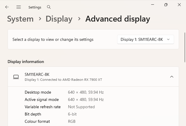

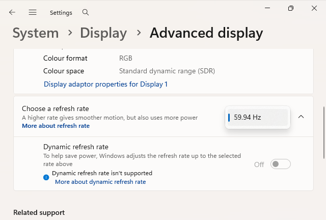

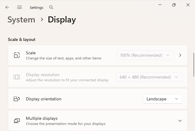

Ok, I flashed MUC's provided EDID on to the SMEARC and it falls back to 640x480@60Hz:
07-10-2026, 10:53 PM (Last edited: 07-10-2026, 10:54 PM by MUC)
Post: #9537
(07-10-2026 01:25 PM)moecre Wrote:  Ok, I flashed MUC's provided EDID on to the SMEARC and it falls back to 640x480@60Hz
That’s not good.
The screenshots show that the EDID is being detected, as the display device is recognized as "SM11EARC-8K", which is exactly what I defined in the EDID. So, I believe your flashing process was successful.

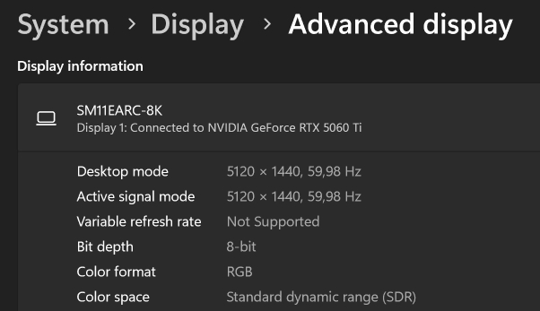

Unfortunately, I don't have an AMD graphics card on hand, so I can't test with one. That doesn't help you directly right now, of course, but I can confirm that the EDID works with an Nvidia graphics card. I have equipment here that allows me to feed EDID to the graphics card externally, so the setup mirrors your use case. When I boot my PC with the Nvidia GeForce RTX 5060 Ti while the EDID I created is active, Windows starts up directly at 5120 x 1440 @ 60 Hz, so the mode defined as "preferred" in the EDID. This shows that the Nvidia driver can handle the CTA-861 extension within a DisplayID. The receiving device confirms a TMDS clock of 469 MHz. Switching to 5120 x 1440 @ 144 Hz using DSC FRL3 (24 Gbps) works without problems, as does enabling VRR. The only issue I see is that 10-bit color cannot be enabled in the Nvidia driver.
You can still operate the PC while it's in that 640 x 480 @ 60 Hz state, right? If so, please run edid-test.exe on the PC. A file named "edid-test.TXT" will be created in the same folder. This file contains the EDID currently detected by the PC. Please attach that file here so we can verify it.
