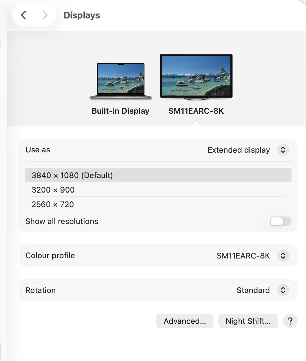

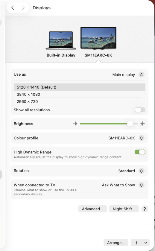

Yes, I tried the MacBook from time to time, it shows a slightly different behaviour than the PC in some scenarios. Your EDID actually works for the MacBook, see     . The panel doesn't show the refresh rate though, is there another way to debug the current refresh rate on macOS?

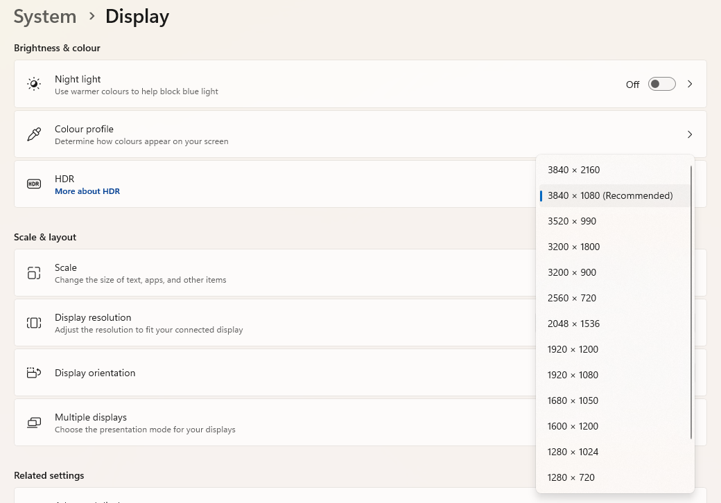

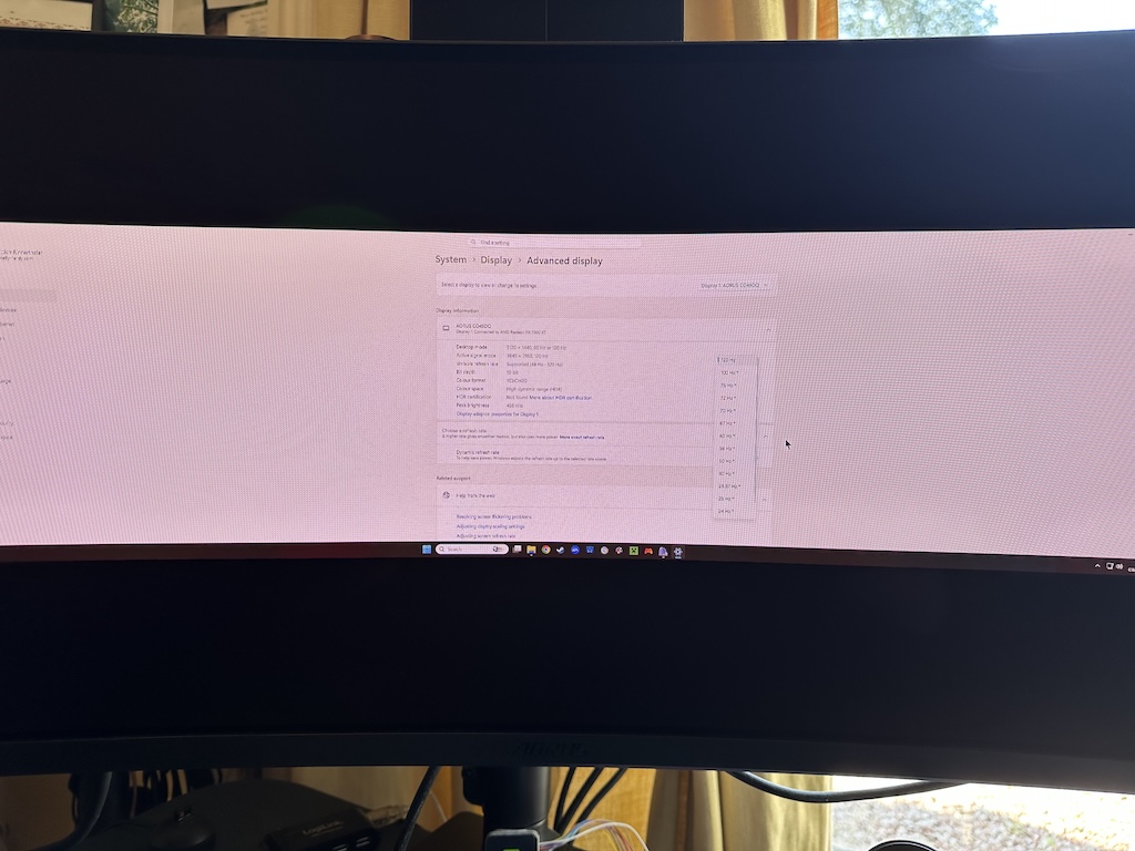

I used CRU only for altering EDID files, haven't done any overwrites on the source PC yet.
I tested the original EDID without overwrites though, see     and     . The monitor seems to display the 5120x1440 in a 4K 16:9 picture. That's btw the same behaviour if I change the dip switches on the device to pass-through. I guess that's a Blustream device thing, maybe related to the small EDID.

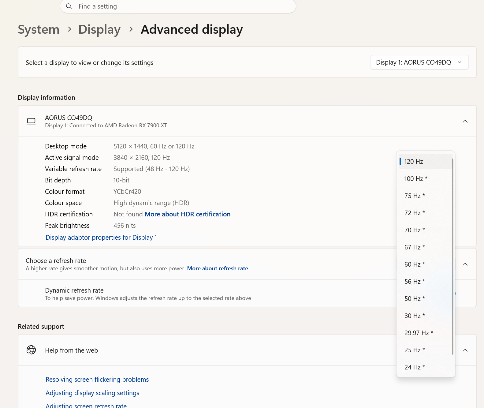

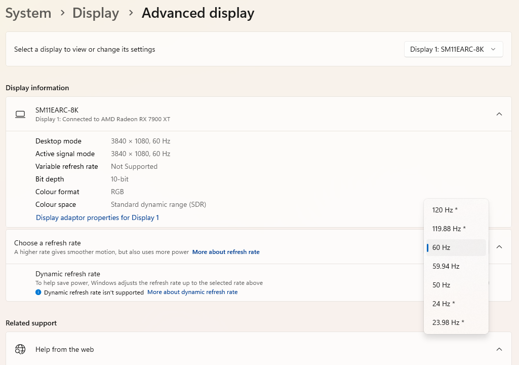

(07-13-2026 08:13 PM)MUC Wrote:  Please try the 256-byte EDID in the attachment on the SM11EARC-8K. If possible, test with all source devices.
Hi Muc,
test summary: it seems as a lot of resolutions and a refresh rate up to 120Hz are possible on PC. But not the desired 5120x1440@144Hz. Same on MAC, but doesn't matter what I choose the display stays black, not so on PC.
