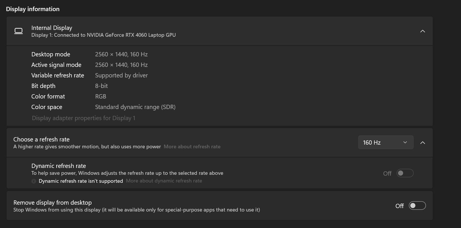

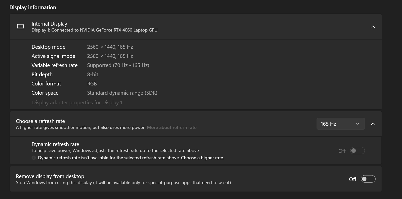

10-04-2026, 10:07 PM
Post: #9577
(08-24-2026 10:41 PM)ToastyX Wrote:
(08-22-2026 03:58 PM)AssadFaszad Wrote:  Hi,
I've got a laptop 1440p@165Hz GSync Compatible screen. I've managed to overclock it to 180Hz without frameskipping. Then I've adjusted V rate range to 180Hz. Windows 11 24H2 lists VRR as "Supported by driver" above 165Hz however it seems to be working fine. Curiously the original EDID has the range as 60-165Hz despite Windows and LFC kicking in at 70Hz. Changing the ID from CSO1509 to even a true GSync panel or one with a wider range removes GSync from NVCP. Are there any tricks or other improvements I could do? Here's the original EDID.
That's all there is to do. Your limitation will be the actual hardware and not anything in the EDID.
I've tried out CRU WIP and managed to finally modify the VRR range outside of the 2 predefined ranges. The predefined ranges are 70-165Hz and 25-60Hz. 70-165Hz blacks out below 60Hz when bypassed. Didn't yet break through 25Hz. What helped was either the G-SYNC or HDMI v2 Data Blocks.
Is it usual for a panel to have 2 ranges? Does it have an effect on overdrive or other things? The laptop specific issue of having "overdrive applied twice" is now yet again present.
With the modified range LFC doesn't kick in at all, or well, I can't see when it does if it happens below 60Hz. And the lower range seems to kick in LFC when below 26Hz.
Even if Windows control panel states that VRR is "Supported by driver", SpecialK recognizes it properly now and the panel uses the modified range.
What does it mean for Windows and software, when Active signal mode and Desktop mode differ?
10-05-2026, 01:48 AM (Last edited: 10-05-2026, 01:49 AM by ToastyX)
Post: #9578
(10-04-2026 10:07 PM)AssadFaszad Wrote:  I've tried out CRU WIP and managed to finally modify the VRR range outside of the 2 predefined ranges. The predefined ranges are 70-165Hz and 25-60Hz. 70-165Hz blacks out below 60Hz when bypassed. Didn't yet break through 25Hz. What helped was either the G-SYNC or HDMI v2 Data Blocks.
You mean two range limits descriptors? That's not common. There should only be one, and the driver would probably only listen to one of them. If HDMI VRR is defined in the HDMI v2 data block, that would take precedence on an HDMI connection, but that shouldn't have any effect on the laptop display. I'm not sure how NVIDIA would handle a G-SYNC block being present.
(10-04-2026 10:07 PM)AssadFaszad Wrote:  With the modified range LFC doesn't kick in at all, or well, I can't see when it does if it happens below 60Hz. And the lower range seems to kick in LFC when below 26Hz.
When the resolutions are different, it means the desktop resolution is being scaled to the active resolution. The refresh rates aren't supposed to be different. I don't even understand how that happens.

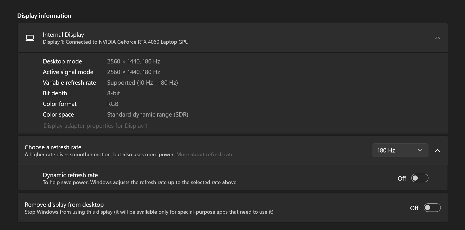

10-05-2026, 07:52 PM
Post: #9579
(10-04-2026 10:07 PM)AssadFaszad Wrote:  Are there any tricks or other improvements I could do? Here's the original EDID.
The panel is a device from China Star Optoelectronics Technology (CSOT), connected via the DisplayPort protocol, likely a 40-pin eDP connection with 4 lanes (HBR3).
Adding HDMI VRR to the EDID should have no effect whatsoever. For DisplayPort "G-Sync Compatible" (=VESA AdaptiveSync) operation, the Nvidia driver only evaluates the range limits from the base block. According to your original EDID, the video timing for 165 Hz complies with the VESA CVT-RB standard.
Therefore, it should be sufficient to adjust the range limits and add the 180 Hz mode (using CVT-RB timing) to the extension block.
Please try the attached EDID.
.bin  CSOT_1440p180_01.bin (Size: 256 bytes / Downloads: 71)
10-08-2026, 06:56 PM
Post: #9580
I did try it, and it did work. I believe this was the first time I saw it running on any other bit depth than 8, as it went down to 6. I do have 180Hz working with 8bit though, but thank you. Do you by any chance have a color profile for this panel?

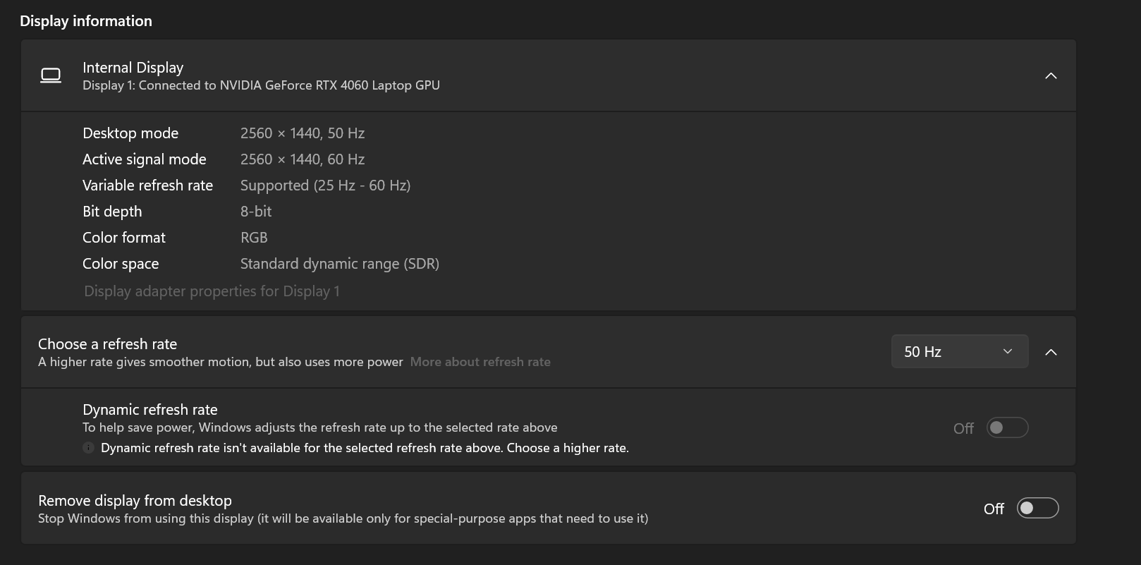

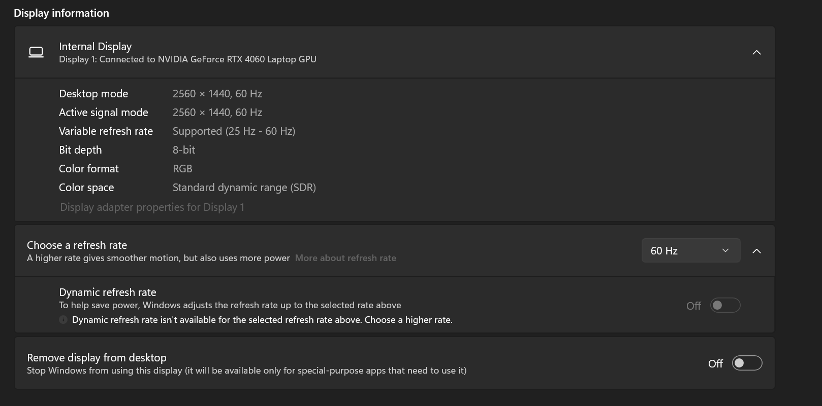

It didn't have two by default. It only had the one in Edit tab. But I did experiment with the G-Sync entry and the HDMI VRR entries. The HDMI VRR entries, as expected, didn't show to have any effect. The G-Sync entry however did have an effect. Firstly it made Windows and SpecialK recognize G-Sync support above the native refresh rate and secondly it allowed me to skip LFC and go below the supported range of the hardware, as it blacked out below 60Hz. Then I experimented with combinations and in CRU WIP if I removed the Detailed resolution from Detailed resolutions and descriptors it'd still go out of range when below 60Hz. I might be wrong though, been a few days ago.
Me neither and didn't find much information on why and how. This happened when @60Hz with G-Sync and in-game with SpecialK I changed to 50Hz for example. Somehow this didn't do the usual change and did a very quick switch. DRR Tool did report 50Hz as well. Didn't do further tests.
The only other scenario where I accomplished this was when I tried to run fractional (fixed) rates, like 168, 144, 120/1.001. The Active signal would be non-fractional while Desktop mode would report the fractional rate. In those cases I didn't do further test or validation either. This also has me curious why or how does 24/1.001 run but not higher multiples of it.
Anyway I didn't keep the G-Sync or other additional VRR range entries as I didn't gain anything from them and only got some problems back (double overdrive, out of range when below 60Hz in very specific situations). If it's of any use, here's the last EDID with my schizoid experiments. It's got a Display Parameters entry from the EDID of the guy in a reply above. Don't know whether it does anything Tongue
