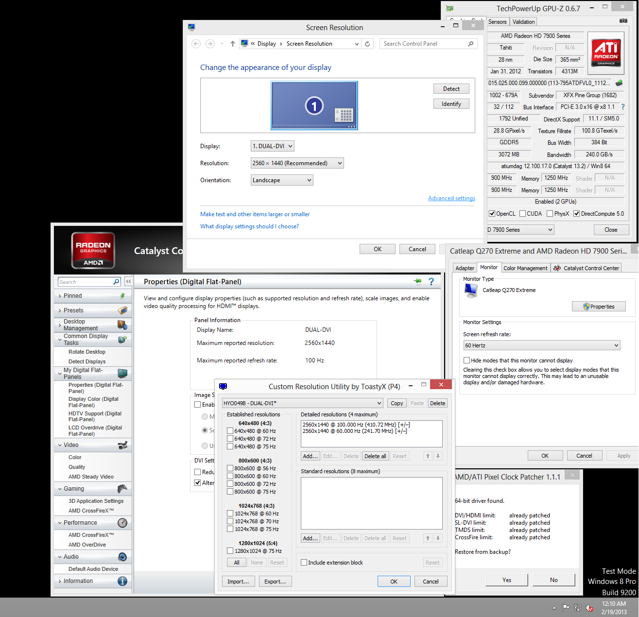

I'm using 13.2 beta 5 drivers (64-bit of course) with XFX 7970's in Crossfire. It worked fine with Windows 7 that I used last week. Got a copy of Windows 8 and reformatted. Did the exact same thing I did on 7, except that it's not working on 8. Sad
CCC sees that the monitor can do 100Hz, but still gives me the option for up to 60. I've had it at 110 Hz for a long time, same with when I had GTX 680 SLI. So my monitor shouldn't have a problem doing 100Hz. I also put on a second Crossfire bridge to see if it helped, but it made no difference. I read through all 5 pages on this thread to see if my question was asked here, but I've followed instructions for everything. Enabled testmode, then installed Catleap monitor drivers. Rebooted. Patched the drivers. Rebooted. Opened CRU and set the 100hz resolution in there and unchecked the extension box. Rebooted. Still no sign of the 100Hz option. It was just working fine with Windows 7 Ultimate 64-bit, and I was using 107Hz. What gives? Sad
02-19-2013, 06:27 AM
Post: #45
Wow nevermind, that was strange. All I had to do was disable Crossfire, and then the 100Hz option appeared. And then I set it to that, and re-enabled crossfire. 100Hz setting still remains applied. Thanks!
