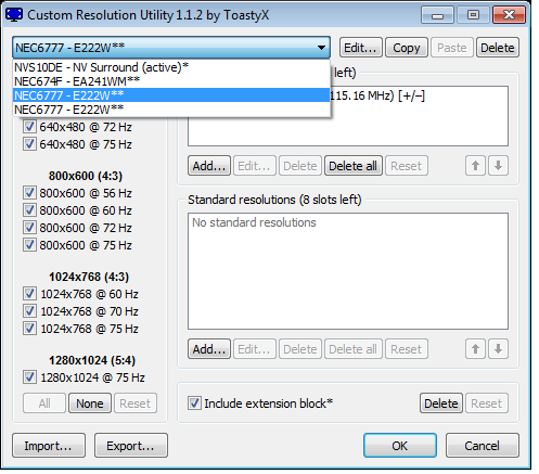

first of all thanks for providing us your great tool! Smile
Here comes my question...
i am using Nvidia Driver 337.88 (on Geforce GTX 770 from Asus)
my screens used for my Triple Screen setup:
2 side screens (22 inch - 1680 x 1050):
Synchronization Range
Horizontal (Analog/Digital) 31.5-82.3 kHz
Vertical 56-75 Hz
Center Screen( 24 inch - 1920 x 1200)
Horizontal (Analog/Digital) 31.5-81.1 kHz
Vertical 56-76 Hz
I wanted to create a working setup with 1680*1050 for each screen.
it is working good but after a reboot, the "effect" has gone and the screens turn back to 60 Hz instead of 58 which I set for all screens before with CRU.
I already tried both methods for Nvidia cards ( disable the extension block and make sure GeForce Experience and Samsung Magician are not installed, or enable the extension block and import this file: blank-extension.dat)
Is this an issue with the current Nvidia driver?
I created an attachement (screenshot)
i use the CRU to get rid of this issue:
http://www.assettocorsa.net/forum/index....ost-167541
