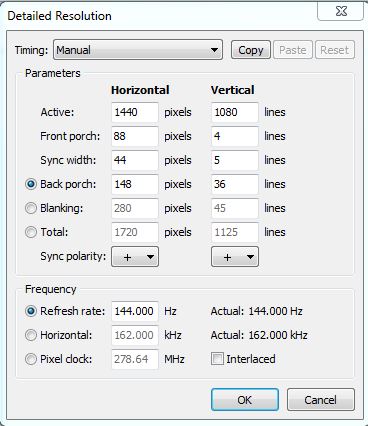

Hello guys, to begin with, this tool is awesome I created a custom resolution : 1440 1080 on my 24" Benq monitor but I have some questions.
Do this will create additionnal input lag? as I do compete in cs go I would like to know that. Plus, I created manually the timing using the same values as the default mode which was in 1920 1024 and just changed the resolution to 1440 1080 and refresh rates to 144 Hz (my monitor capable Hz) but for the timings I don't know if it gives me a disavantage or not as I see LCD reduced timings which have really different values that I have. I don't understand what these values do but I would like to know if default are better or LCD reduced for input lag and such . I linked my CR you can see the timings there. For my testing I've tested using vsync it correctly sync at 144 fps in my game and I used a map which could test your reaction time and it was quite good like before but I want to be sure ![]() should I use standard or reduced lcd mode with my benq 2411t? Cordially. |

(09-18-2014 10:59 AM)noyaux Wrote: Hello guys, to begin with, this tool is awesome I created a custom resolution : 1440 1080 on my 24" Benq monitor but I have some questions.It depends on the monitor, but with most monitors, no. If the monitor did add lag with lower resolutions, you could use GPU scaling instead. (09-18-2014 10:59 AM)noyaux Wrote: Plus, I created manually the timing using the same values as the default mode which was in 1920 1024 and just changed the resolution to 1440 1080 and refresh rates to 144 Hz (my monitor capable Hz)The "LCD reduced" option was meant for trying higher refresh rates at the native resolution. I would use "LCD standard" if that works. The values won't have a significant impact on lag. In theory, the refresh will finish slightly faster with a higher vertical blanking/total, but we're talking less than 1 ms in most cases because most monitors won't accept a high enough value to make a significant difference. |
