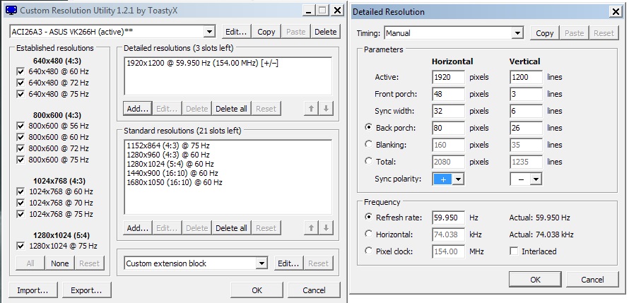

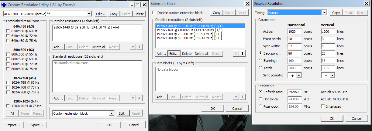

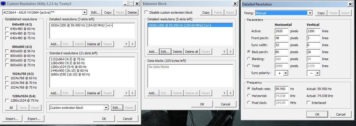

I have one issue... my main monitor will not work with Nvidia Surround, though the left and right secondary screens work perfectly. Here's the details:
I have an Acer XB270HU 27" G-Sync display and tring to get tri-monitor Nvidia surround working with an Asus VW266H and a VK266H. Seeing as the 2x Asus monitors are 1920x1200@60hz, I have set the XB270HU to those dimensions and refresh rate. I have set all the monitors to the exact same settings in CRU. Each and every time I click 'Enable Surround', the screens flicker for a few seconds and the 2x Asus start working in Surround, but the center XB270HU just goes black with no response. I have also tried dropping the refresh rate to 59.950 across all 3 in an attempt to get it working without success.
It would seem that without setting everything correctly you would not even get the option to click "Enable Surround", I just have no idea how I could get to this stage and have the Acer shut down. FYI it is a 27" G-Sync monitor 144hz 2560x1440 native res display. The other 2 screens are older models.
Here are snapshots of the CRU settings for all 3 monitors:
(I was messing with the Sync polarity [+] and [-] while testing so that's why the Acer snapshot is different in these pics. It still doesn't work no matter what I set).
Any clues you can think of?
Thanks!

(08-17-2015 05:15 AM)KVorkian Wrote:  I have an Acer XB270HU 27" G-Sync display and tring to get tri-monitor Nvidia surround working with an Asus VW266H and a VK266H. Seeing as the 2x Asus monitors are 1920x1200@60hz, I have set the XB270HU to those dimensions and refresh rate.
The Acer XB270HU doesn't support non-native resolutions. This setup is not possible unless the ASUS monitors can scale down 2560x1440, which isn't likely.
