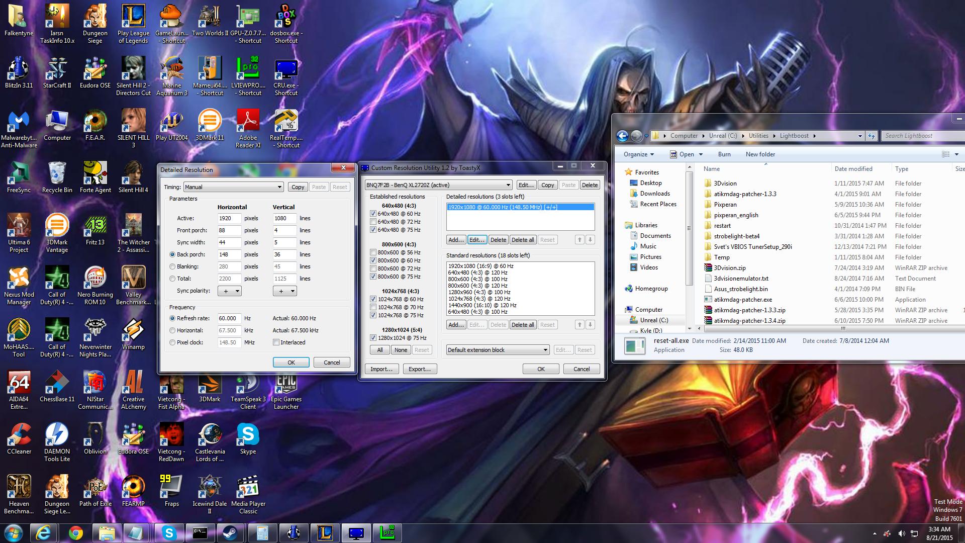

Sorry if this was asked before, but what exactly is the difference between driver "Default" timings and CRU default timings that have a lower HT and porch values? Example: (at least on AMD) in windows, The default timings for 1920x1080 for the Benq XL2720Z / 2420Z/2411Z are: front porch 88 pixels, 4 lines Sync width 44 pixels, 5 lines Horizontal 2220, Vertical 1125. Yet CRU uses these defaults for lightboost mode, for example: front porch 48,3 sync width 32,5 Horizontal: 2080 VT (1138,1143 or 1149 for 100, 110 and 120hz lightboost). Using the higher values works fine also without a problem for normal lightboost However over a DISPLAYPORT connection, strange things start happening at a few specific custom refresh rates. Certain specific custom resolutions / timings with the 2200 HT and 88 front porch timings will simply make the monitor shut off over displayport only, but not over DVI ! Some examples from my XL2720Z: 60hz lightboost (double strobe; just a curiousity): 2200 HT, 1155 VT, 60hz (this activates 60hz lightboost at 120hz strobe pulses on my XL2720Z, so it strobes twice per refresh) Front porch 88/4 sync width 44/5 (note this does not work on the Asus VG248QE ! You need VT 1179 to get 60hz lightboost) Displayport: monitor shuts off instantly. DVI: no problem. 2080 HT, 48/3 front, 32/5 sync, 60hz, 1155 VT Displayport: no problem. 50hz (custom resolution and VT required to enable benq blur reduction at 50hz with single strobe enabled; monitor will NOT strobe at all at default 50hz anything): front porch 88/4, sync 44/5 HT 2200, VT 1360, 1920x1080@50hz Displayport: monitor shuts off DVI: works fine. Front porch 48/3, sync 32/5 HT 2080, VT 1360, 50hz no problem on DP, DVI. Note: higher refresh rates like 100hz, 120hz, 85hz, etc work fine with the 2200 HT, etc and VT 1500. |

(08-20-2015 08:44 PM)falkentyne Wrote: ToastyX:I don't know what you mean by default. The monitor defines the timing parameters in the EDID. The driver gets the timing parameters from the monitor. CRU shows what the monitor defines and lets you override that. (08-20-2015 08:44 PM)falkentyne Wrote: Example: (at least on AMD) in windows,Those are the CEA standard timing parameters for 1920x1080 @ 30/60/120 Hz. CRU uses the same timing parameters for "LCD standard" at 1920x1080 @ 30/60 Hz and for "LCD native" at all refresh rates. (08-20-2015 08:44 PM)falkentyne Wrote: Yet CRU uses these defaults for lightboost mode, for example:CRU doesn't have the LightBoost modes programmed into it. Strobelight uses those timing parameters because that's what I determined was being used when NVIDIA's driver activated 3D mode with the ASUS VG248QE. Those are just the CVT-RB standard timing parameters with the vertical back porch/blanking/total increased by 5. CRU uses CVT-RB for "LCD standard" at 1920x1080 @ 120/110/100 Hz, which also matches what the ASUS VG248QE defines for those refresh rates. Are you saying the BenQ defines something different? |

Quote:CRU uses CVT-RB for "LCD standard" at 1920x1080 @ 120/110/100 Hz, which also matches what the ASUS VG248QE defines for those refresh rates. Are you saying the BenQ defines something different? Yes but this is at 60hz. On a FRESH driver install, after a full reset (or you can run reset all in CRU), the following line exists in detailed resolutions on the Benq XL2720Z: : 1920x1080@60 Front: 88/4 Sync: 44/5 HT 2200 VT: 1125 Are you saying that this is only for 60hz and not for 100, etc? (I have no way of knowing what's shown for 100/110/120 etc). What I do know is, for the 60hz above: Over DISPLAYPORT: If I change the 1125 VT to 1155 VT, the monitor just shuts off. Over DVI, it doesn't. But if I change the timings to CVT-RB so it has the 2080 HT, then it activates lightboost mode double strobed. I attached a screenshot after using reset-all. I'm guessing then that the displayport "Loss of signal" issues with some of the custom timings are simply a firmware problem. I know that V4 firmware (according to someone that emailed Benq about their V3 monitor losing signal on DP (and only on DP) and they getting RMA'd and shipped back a V4 from Benq Europe) and they replied back to them) officially fixed displayport loss of signal problems whenever the monitor went to sleep. I guess not "all" of the bugs were fixed, then. |

(08-21-2015 10:36 AM)falkentyne Wrote: On a FRESH driver install, after a full reset (or you can run reset all in CRU), the following line exists in detailed resolutions on the Benq XL2720Z: :Most monitors use those timing parameters for 1920x1080 @ 60 Hz, including the ASUS VG248QE. Strobelight also uses those timing parameters for 60 Hz. Most 120 Hz monitors use CVT-RB for 120/110/100 Hz. You can see what the BenQ defines in the extension block by running reset-all.exe and restarting, and then use GetEDID or MonInfo to save the full EDID to a file that you can import into CRU. (08-21-2015 10:36 AM)falkentyne Wrote: What I do know is, for the 60hz above:I'm pretty sure LightBoost is supposed to use the CVT-RB 2080 HT, not the CEA 2200 HT. |
