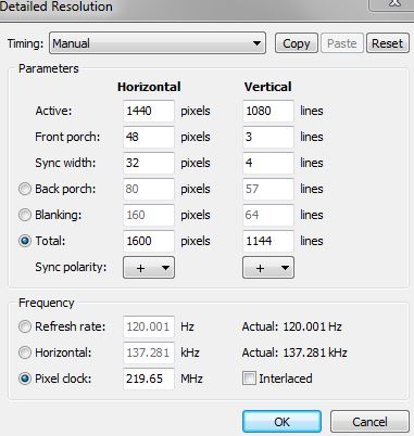

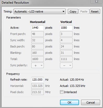

i have problem with setuping new resolution for my monitor Eizo FG2421.
I want to have 1440x1080 on 120Hz.
When i go to add detailed resolution and set timing: automatic - LCD native
and set 120Hz refresh rate, after switching resolution i get black screen with display port signal error.
Can anyone help me? Thanks in advance.

(11-27-2015 05:33 PM)drom Wrote:  Hello,
// i make it to work with GPU scaling/ virtual super resolution
I think LCD native is for 60hz.
Try to use LCD Standard for 120hz.
You're using wrong timings for 1440x1080 and most likely the scaler isn't accepting it.
Pretty sure the Hor total should be 1600 and vertical total should be 1144.
Front porch 48, 3
sync width 32, 4
HT: 1600
VT: 1144
Pixel clock: 219.65
If that works, you may be able to lower the Vertical total, if you want a 1:1 aspect setting instead of full screen ;
You can set the vertical total to 1125 if you want to allow the monitor OSD to select "dot to dot" (1:1) or "aspect for 1440x1080.

Wow it works, where do you get those correcr numbers ? Smile
Thank you man!

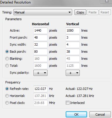

(11-27-2015 11:28 PM)drom Wrote:
(11-27-2015 09:16 PM)falkentyne Wrote:  [quote='drom' pid='4855' dateline='1448645592']
And it works with V total 1125 too Smile
