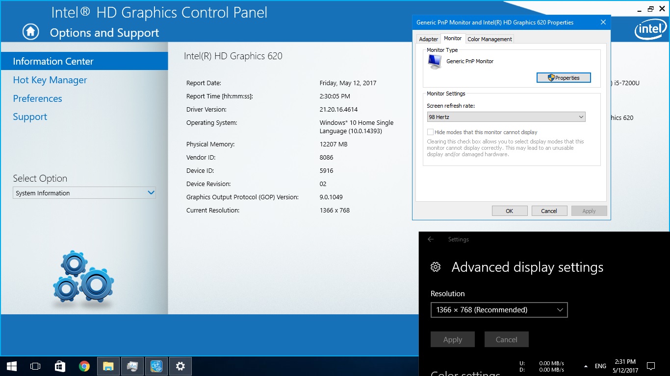

05-12-2017, 01:39 PM (Last edited: 05-12-2017, 01:40 PM by ojcrisanto)
Post: #2827
overclocked my laptop display from 60hz to 98hz :-D big thanks for this.
my laptop is MSI cx62 7ql.
