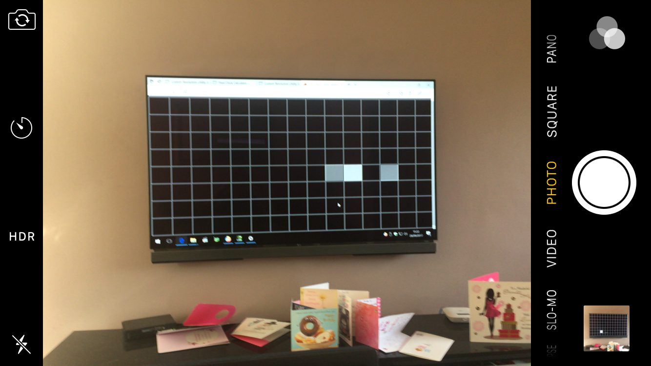

(09-27-2017 04:02 PM)Jarvmeister Wrote: Hi, I've been trying to set up a custom resolution for my LG OLED E6V. I am trying to set a resolution of 1920x1080 with a refresh of 47.952 (2 x 23.976) and if I can get that working I'd like to try 71.928. I've created these refresh rates using CRU, and they are available for me to select when changing my adapter settings and monitor refresh rate. I can select them and confirm that MadVR detects I'm running at the refresh rate I've just created. Something isn't working though, since films that are 23.976fps should in theory look the same as they do with my 23.976hz refresh rate, but they look much more choppy. I would like to use these custom refresh rates, if I can get them working properly, to use SVP, as I'd like to eliminate the need for Reclock.Some TVs and monitors are locked to 60 Hz and will skip frames at higher refresh rates (and duplicate frames at lower refresh rates, causing judder). Use this test with a camera to verify: http://www.testufo.com/#test=frameskipping |

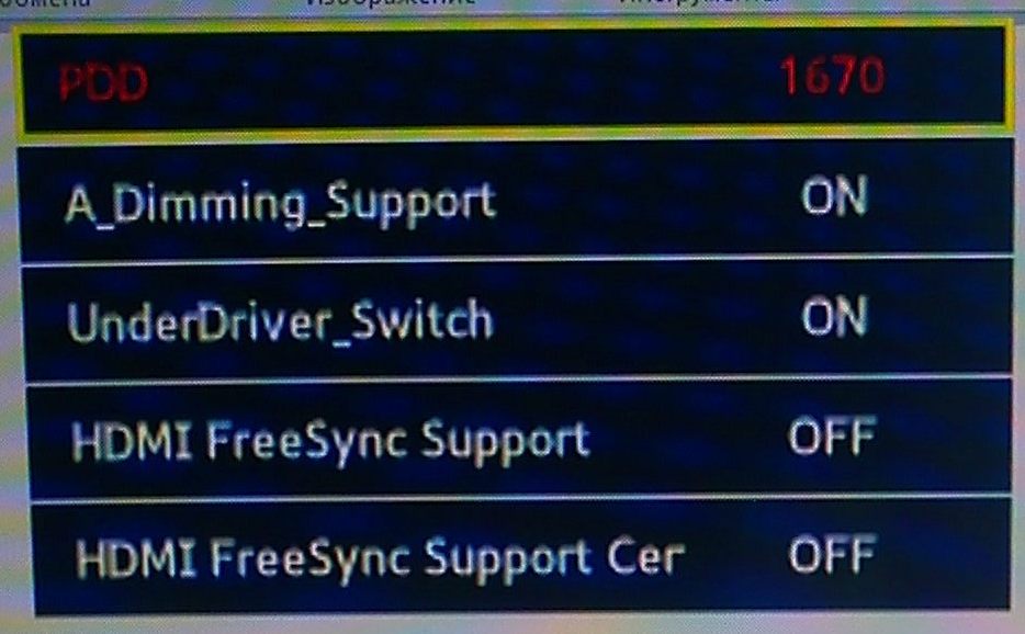

"ToastyX Wrote:forums.guru3d.comThe problem is most LCD monitors have scalers. Special hardware like scalers actually get in the way of this. That's why many people are seeing their monitors black out when they try this. LCD monitors with scalers are less likely to work without firmware changes because the scalers are usually designed to handle a limited range of refresh rates and timing parameters. That's why the scaler chips need to be updated to support FreeSync.I have V32F390F Samsung monitor (1920x1080 60Hz, HDMI 1.4). After executing the instructions on the first page, FreeSync is activated in the driver. Check in the windmill AMD utility leads to a spontaneous transition of the monitor to 50Hz. At 50Hz, FreeSync runs nice and more smoothly than Vsync. But any other refresh rate lead to black screen. It's the same in games. Vertical Frequency 24 - 72 Hz is indicated in the monitor specs, but any refresh rate (setup in CRU) more than 60Hz on 1920x1080 lead to black screen. Some other resolutions with a refresh rate of less than 60Hz also don't work. Although 1280x1024 75Hz is working fine. Am I understand correctly that scalar is installed on this monitor, and this is the cause of the problems? Are there any solutions in my case? (translated by Google) |

(09-27-2017 11:59 PM)ToastyX Wrote:(09-27-2017 04:02 PM)Jarvmeister Wrote: Hi, I've been trying to set up a custom resolution for my LG OLED E6V. I am trying to set a resolution of 1920x1080 with a refresh of 47.952 (2 x 23.976) and if I can get that working I'd like to try 71.928. I've created these refresh rates using CRU, and they are available for me to select when changing my adapter settings and monitor refresh rate. I can select them and confirm that MadVR detects I'm running at the refresh rate I've just created. Something isn't working though, since films that are 23.976fps should in theory look the same as they do with my 23.976hz refresh rate, but they look much more choppy. I would like to use these custom refresh rates, if I can get them working properly, to use SVP, as I'd like to eliminate the need for Reclock.Some TVs and monitors are locked to 60 Hz and will skip frames at higher refresh rates (and duplicate frames at lower refresh rates, causing judder). Use this test with a camera to verify: http://www.testufo.com/#test=frameskipping I took this screenshot with the monitor set to 75hz, I assume this means I'm skipping frames? |

(09-28-2017 11:17 AM)alessander Wrote: I have V32F390F Samsung monitor (1920x1080 60Hz, HDMI 1.4).All monitors with HDMI have scalers. CRU is not meant for making FreeSync work with non-FreeSync monitors. The FreeSync data block is provided for editing the FreeSync range with HDMI FreeSync monitors. |

(09-29-2017 09:07 AM)ToastyX Wrote: All monitors with HDMI have scalers. CRU is not meant for making FreeSync work with non-FreeSync monitors. The FreeSync data block is provided for editing the FreeSync range with HDMI FreeSync monitors.That is, everything that was discussed in guru3d topic is no longer actual, and activation FreeSync in non-FreeSync monitors not possible? I understand that some people did it after all. I began to study this question, because the manual for this monitor contains records about FreeSync. But as it turned out, this applies to model V27F390F only. V32F390F service menu contain FS settings, but they don't change anything concerning of FS support. Does it make sense to flash it with firmware from V27F390F? |
