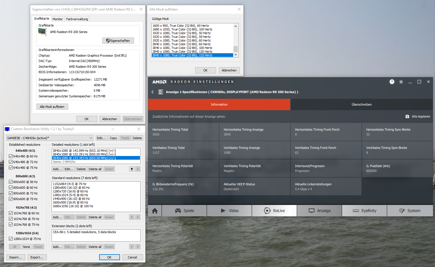

(11-28-2017 12:11 AM)Haldi Wrote: Are there any known issues with Windows 10 and 144hz?No. (11-28-2017 12:11 AM)Haldi Wrote: my Samsung C49HG90 Monitor should be able to run 144hz, but i only see 120hz in the settings.I don't think your video card supports pixel clocks greater than 600 MHz. Was it working before Windows 10? |

(11-28-2017 02:28 PM)ToastyX Wrote: I don't think your video card supports pixel clocks greater than 600 MHz. Was it working before Windows 10? That seems to be True. Pixelclock of 600 is the maximum, resulting in 132.291hz Oh, but because 3840*1080*32*132 is 17'517'772'800 which is slightly above DP1.2 Speccs it goes down to 8bit. 126mhz seems to be closest possible with 10bit. Thanks. Are there any known ways in overclocking DP Pixel clock? IIRC that only works on HDMI/DVI ? |
