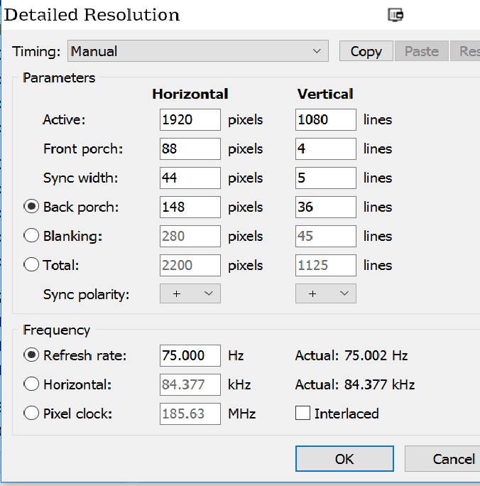

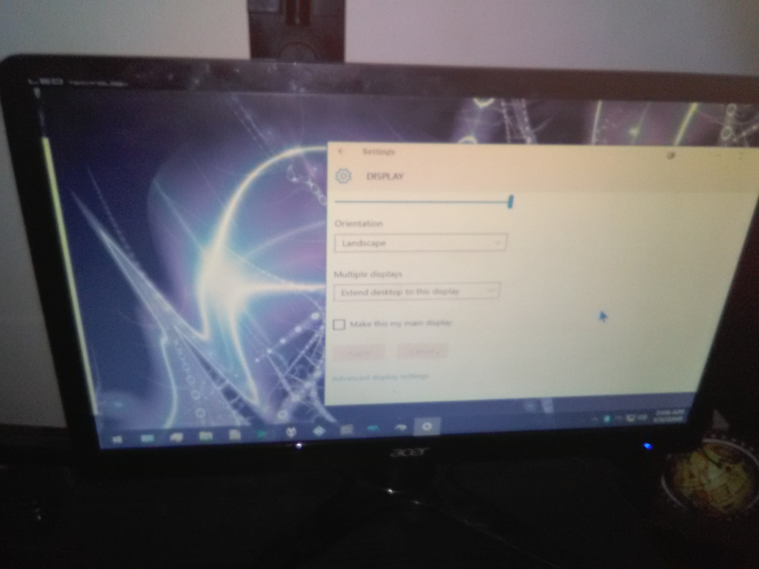

01-01-2018, 08:55 PM (Last edited: 01-01-2018, 09:00 PM by NexusP)
Post: #3376
When I add a resolution of 1920x1080@75hz, my monitor shifts to the right. When pointing the mouse to the right, you can see it on the left. My default monitor resolution is 1600x900. The custom resolution works with no issues when added with Nvidia. I need to use CRU so the resolution shows up in Spheck (MilkDrop Plugin) for Foobar. The same happens with 60hz. I tried interlaced and it worked but Spheck will not pick up the resolution with that setting. I didn't change anything else. I tried manual and LCD Native\Standard. Everything else blanks out. The settings seem to be the same as what's there for my native resolution. Any advice?

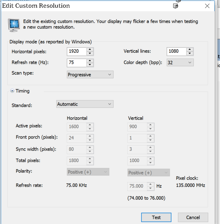

01-02-2018, 12:57 AM (Last edited: 01-02-2018, 07:25 AM by NexusP)

(01-01-2018 10:09 PM)ToastyX Wrote:
(01-01-2018 08:55 PM)NexusP Wrote:  When I add a resolution of 1920x1080@75hz, my monitor shifts to the right. When pointing the mouse to the right, you can see it on the left. My default monitor resolution is 1600x900. The custom resolution works with no issues when added with Nvidia. I need to use CRU so the resolution shows up in Spheck (MilkDrop Plugin) for Foobar. The same happens with 60hz. I tried interlaced and it worked but Spheck will not pick up the resolution with that setting. I didn't change anything else. I tried manual and LCD Native\Standard. Everything else blanks out. The settings seem to be the same as what's there for my native resolution. Any advice?
What monitor? DVI? HDMI? DisplayPort? What settings are you using with NVIDIA?
The Monitor is a Acer, G206HL connected via DVI. I have several resolutions that work all the way up to 3840x2160@75. Via the Nvidia Custom Resolution tool. I just added the Resolutions and the refresh and changed nothing else. I'm using a GTX 970. Everything else is greyed and set to automatic.

01-02-2018, 04:11 AM
Post: #3379
(01-02-2018 12:57 AM)NexusP Wrote:  The Monitor is a Acer, G206HL connected via DVI. I have several resolutions that work all the way up to 3840x2160@75. Via the Nvidia Custom Resolution tool. I just added the Resolutions and the refresh and changed nothing else. I'm using a GTX 970. Everything else is greyed and set to automatic.
Your monitor can't handle those resolutions. You are creating scaled resolutions with the NVIDIA control panel. CRU doesn't create scaled resolutions.
01-02-2018, 07:01 AM (Last edited: 01-02-2018, 07:10 AM by NexusP)
Post: #3380
I'm not using DSR. Does it behave the same regardless? When I use it with VorpX, it is an improved difference. The resolutions take hold with no out of range warning which I get with a higher refresh, and the desktop looks obviously bigger in 3840x2160@75. it's not that CRU isn't working with 1920x1080@75, it's shifted over a few pixels to the right. Is there no way to make adjustments conducive to that resolution?
