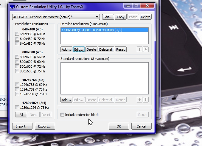

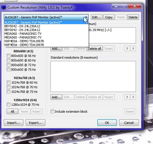

Yes it shows active for the display and the device manager shows generic pnp monitor. I also had a bunch of them the same which i all deleted and had CRU redetect the active display.

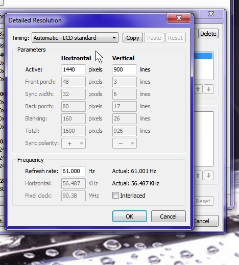

What about if you make a small change like 61 Hz? Make it the first detailed resolution.

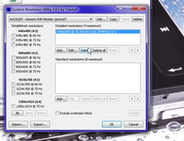

I will try that, i had earlier used automatic and just put 75hz? Think that was too much?

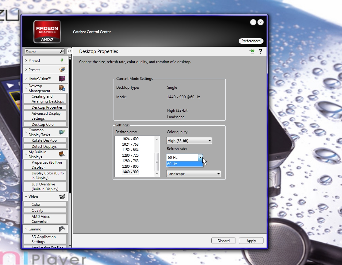

I couldn't get it to work. Here are some screenshots.

It looks like EDID overrides don't work with your laptop for some reason. I'm not sure why. Does it work for external displays?
