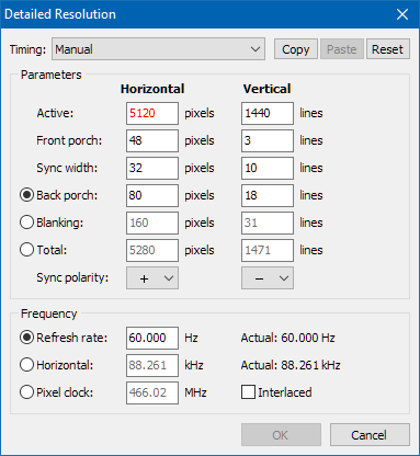

Hello everybody,
first thank you for your utility It is unique and offers right now where Microsoft has completely removed the properties of the new Intel graphics drivers at least one way here myself manual resolutions to be able to define.
I have only one problem, I use the new DELL U4919DW with a resolution of 5120x1440 @ 60hz. I could still set this resolution Manually with my Surface Pro 4, but with my Surface Pro 6 and the new Drivers for Intel HD Graphics 620 this is not possible any more.
Your utility is so that I can not specify 5120px because then the number appears red and I can not save it.
Can I force or rename this somehow that i can use 5120?
Many Thanks!

(11-29-2018 07:21 AM)Airon Wrote:  I have only one problem, I use the new DELL U4919DW with a resolution of 5120x1440 @ 60hz. I could still set this resolution Manually with my Surface Pro 4, but with my Surface Pro 6 and the new Drivers for Intel HD Graphics 620 this is not possible any more.
You have to use a DisplayID extension block to add resolutions that high, but the monitor should already define 5120x1440 in the EDID, so I'm not sure CRU will have any effect.
