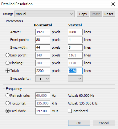

Is this a laptop screen? Try increasing the vertical total without changing the pixel clock to get 60 Hz. If you take a 120 Hz resolution and lock the pixel clock, you can get 60 Hz by doubling the vertical total.
Example:
Yes, is a gaming laptop ASUS GL703GS.
WOW! Exactly the kind of help I needed! It worked! Smile
Thank you so much! I can finally set up 60Hz as a fallback compatibility mode for some nasty coded old games/emulators!

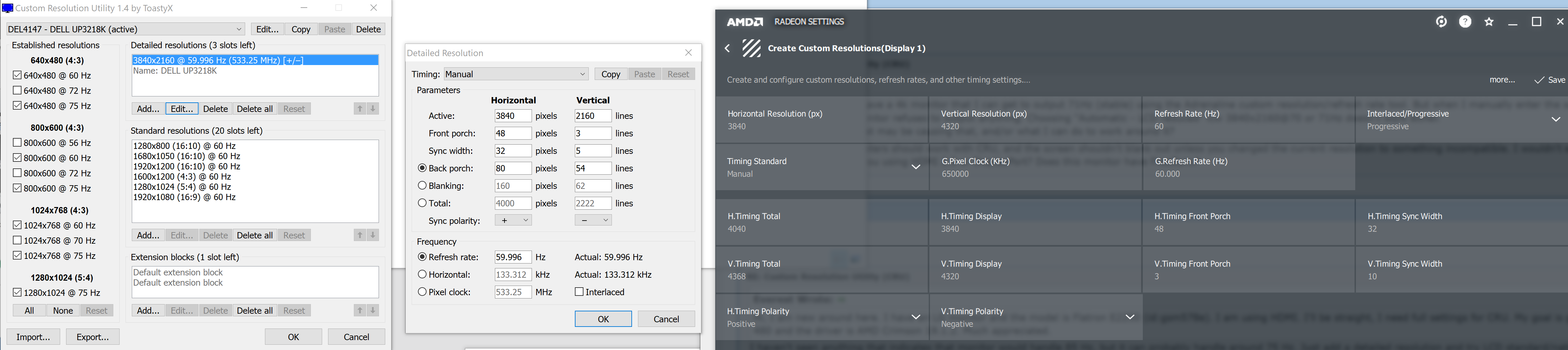

Dell UP3218K, 8k monitor.
Desktop running in MST 7680*4320 (2x 3840*4320?) 60Hz.
I can only see a 3840x2160 mode in CRU Detailed resolutions (3 slots left). Any clue why I don't see more resolutions listed like the 8k? Is it because of MST?
I was hoping to add a 75hz+ 4k mode for gaming. 60Hz @4k is running fine when selected from within fullscreen games.
This panel, it's pretty spectacular and fast electronics. Could it in reality be alot faster on 4K refreshrate than 75Hz given it can do 8k 60Hz under MST with no hiccups?
Is there a way to trial/force VESA Adaptive Sync even though the screen according to AMD control panel is not detected Freesync? Are not all screens better than DP 1.2+ capable of VESA Adaptive Sync in some form. This one is DP1.4 on bot MST ports.
I run it on a Vega 64 8GB but will upgrade in a few weeks to Radeon VII 16GB.

(02-03-2019 09:33 PM)crion Wrote:  Dell UP3218K, 8k monitor.
That's because those resolutions are in the extension blocks. CRU asks the driver for the full EDID, but if the driver can't provide it for some reason, then CRU can't read the extension blocks. If you made any changes, run reset-all.exe and reboot. Then run the attached file once and upload the log file here.
.zip  amdtest.zip (Size: 455.21 KB / Downloads: 1595)
(02-03-2019 09:33 PM)crion Wrote:  I was hoping to add a 75hz+ 4k mode for gaming. 60Hz @4k is running fine when selected from within fullscreen games.
I doubt that monitor will handle 75 Hz correctly, and there's no way to force FreeSync with DisplayPort.
