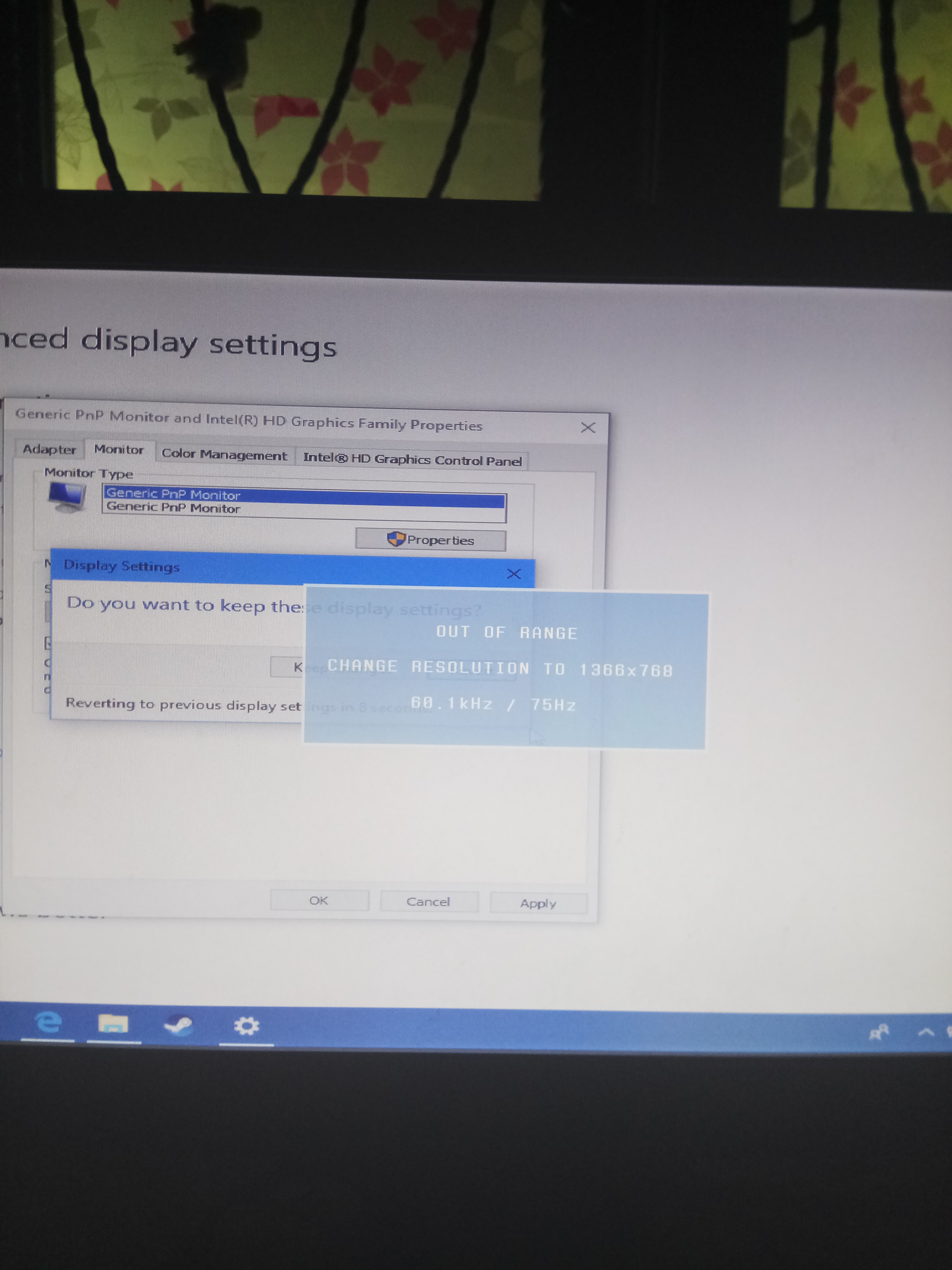

Well this application is very good but I have a problem
I used HDMI to connect my laptop to my LG Flatron monitor
and every time I have applied my settings changing the refresh rate from 60Hz to 75Hz it said "Out of Range, Change your resolution to 1366 x 768, 60.1kHz / 75Hz"
I have used extension block HDMI but not worked too
but at the background of the massage it worked well with 75Hz but after 20 seconds my monitor going blank
Please I Need Your Help :')
