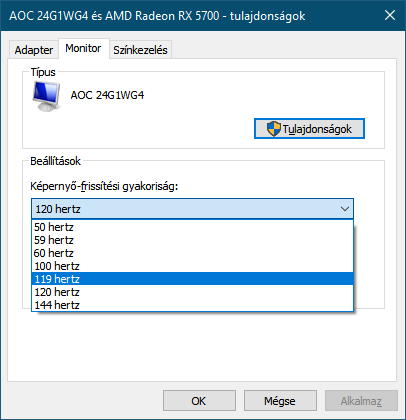

(02-15-2020 07:11 PM)benoe Wrote:  My goal is to make my radeon card lower it's memory clock rate when idle by increasing the vertical blanking lines. This increases pixel clock.
I don't know anything about that. The EDID says the max pixel clock is 330 MHz so you're kind of limited. If you increase vertical lines then you need to decrease horizontal numbers to keep the pixel clock below 330 MHz.

(02-16-2020 04:57 AM)joevt Wrote:  That's the EDID for the DisplayPort connection. It shows the 120Hz timing that you were missing from the EDID for the HDMI connection. Can you post the EDID for the HDMI connection for comparison?

(02-16-2020 10:33 AM)benoe Wrote:  This must be the edid for the hdmi.
Yes, but it also has the 120Hz timing, so I don't know why you couldn't see it in CRU. It's the first timing in the CTA-861 extension block: 1920x1080 @ 119.982 Hz. I think you were only looking in the base EDID block where the 60 and 144Hz timings are.
Seems strange that it would include the 144Hz (325.080MHz) timing when the max pixel clock is set to 300MHz for HDMI.
That I can edit, but it isn't the 119Hz setting from here?

(02-16-2020 08:36 PM)benoe Wrote:  That I can edit, but it isn't the 119Hz setting from here?
I don't know.
There are also these:
640x480 119.999 Hz (Standard)
800x600 120.000 Hz (Standard)
1024x768 120.000 Hz (Standard)
1920x1080 119.982 Hz 137.260 kHz 285.500 MHz (Detailed)
1920x1080 120.000 Hz 135.000 kHz 297.000 MHz (TV)
