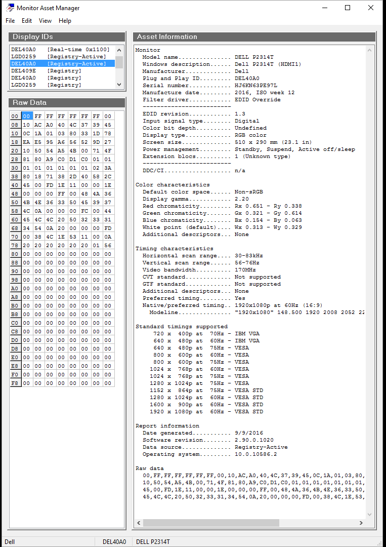

.txt  moninfo Dell 2314T realtime 0x1100.txt (Size: 7.11 KB / Downloads: 1247)

So it means, the Dell D3100 USB 3.0 Docking station is a problem for this resolution?

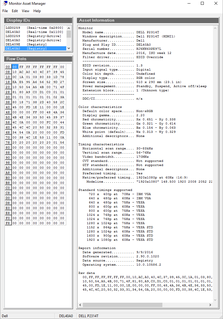

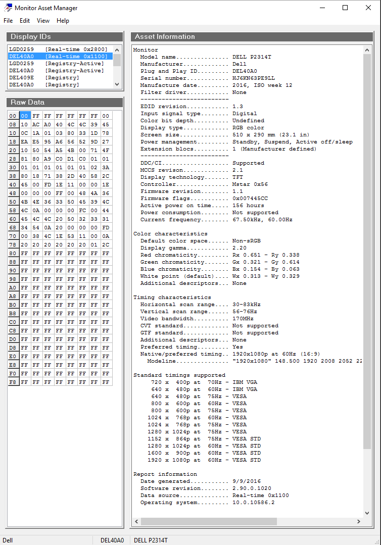

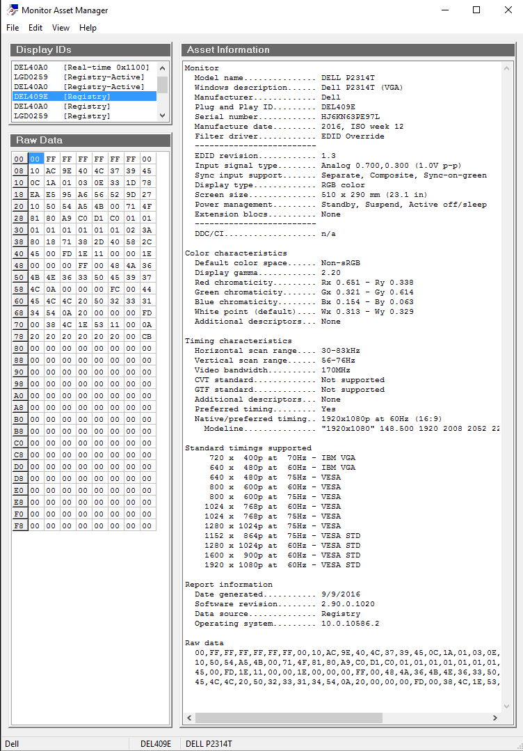

I managed to write to monitor driver the resolution 1280x768. See enclosed files. If it is OK, I do not know. But as you mentioned, via the Dell D3100 USB 3.0 Docking station and HDMI port I am not able to set this resolution. That is a pity. Is there any workaround for DELL p2314t driver or Dell D3100 USB 3.0 Docking station?
When I conected monitor Dell p2314t via internal VGA port on HPEliteBook8570W the resolution of1280x768 is there.
As far as I found, EnTech Taiwain was prepared the drver for this monitor. Should I write to them?
Anyway, I will try later Display port.
Thank you a lot for your help and time.
.txt  Dell P2314T real time.txt (Size: 3.3 KB / Downloads: 913)
.txt  Dell p2314T Registry active.txt (Size: 2.66 KB / Downloads: 898)
.txt  Dell p2314t registry.txt (Size: 2.5 KB / Downloads: 859)
.bin  from get EDID.0.0.bin (Size: 128 bytes / Downloads: 955)
.txt  from get EDID.0.0.txt (Size: 414 bytes / Downloads: 839)

Monitor drivers can't add resolutions unless the driver supports EDID overrides, which the DisplayLink driver doesn't.
Maybe you can try the HDMI pin 19 tape trick to block the EDID and get a default set of resolutions:
https://www.google.com/search?q=hdmi+pin...k&tbm=isch

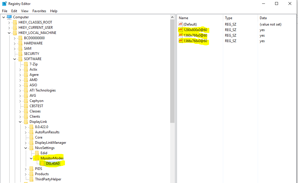

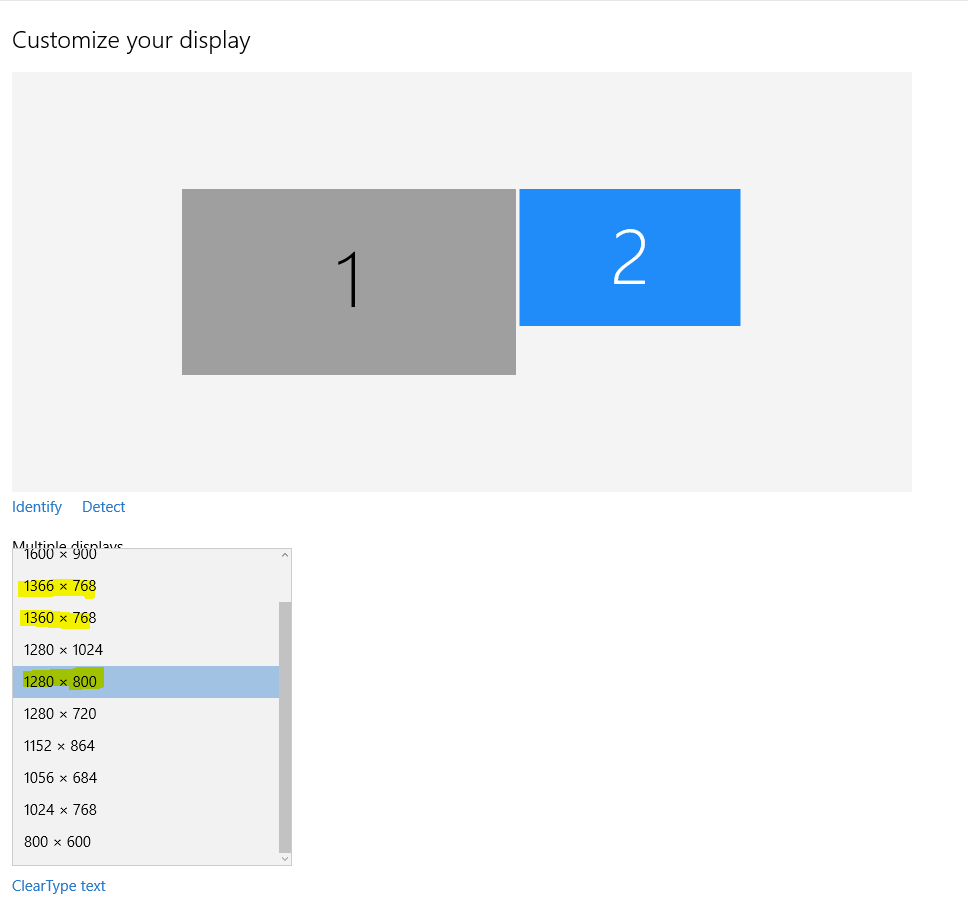

This article help me:
http://support.displaylink.com/knowledge...-when-conn
and resolution for second monitor was added. See enclosed screen shoots files. So updating registry for Dell3100 helps.
