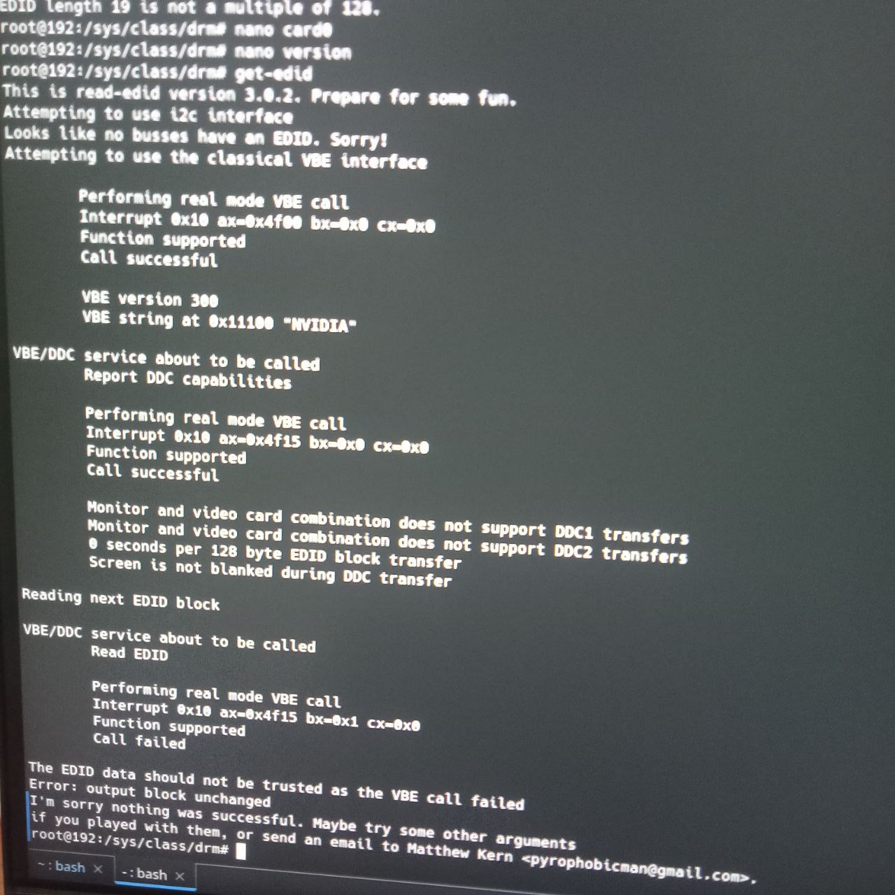

(01-26-2025 08:39 PM)ToastyX Wrote: Either there's a problem with the monitor's EDID, or there's a bug in the GPU's firmware. Similar issues with the RTX 3060 were solved with a firmware update, but I don't see an update for the RTX 2060. If the monitor works with other NVIDIA GPUs, then it's likely an issue with the GPU's firmware not being able to handle something in the EDID. In that case, you should contact NVIDIA support because this is something they would need to fix. You should also contact Gigabyte support in case they have a firmware update. it looks like it because when running it on recovery mode(debian 12) those errors no EDID but I can't tell if it's the vga or the hdmi outputting them, but also seg faults when I switch to it after boot and log on which seem to crash things, almost like my monitor is trying to inject code into the system or something(it's brand new out of the box), I can run it without EDID by adding a file in /etc/X11/xorg.conf apparently but that's a solution a guy that made his own GPU came up with, I will try to get access to a PC to get a edid test but it will be difficult, thanks for replying. (is it possible to run this file on linux?) EDID test on my PC with the vga adapter: https://limewire.com/d/64c0710b-a3e7-418...F0WAchZqb0 how it looks like when I manage to switch to hdmi and log into x11: https://www.anonfile.la/eWcRoUx5 |

The edid-test needs to be run without the adapter and without any EDID overrides. Do you have Windows or only Debian? I just need some way to get the monitor's HDMI EDID. Debian has a read-edid package with get-edid, but it might not work if the EDID is corrupted.

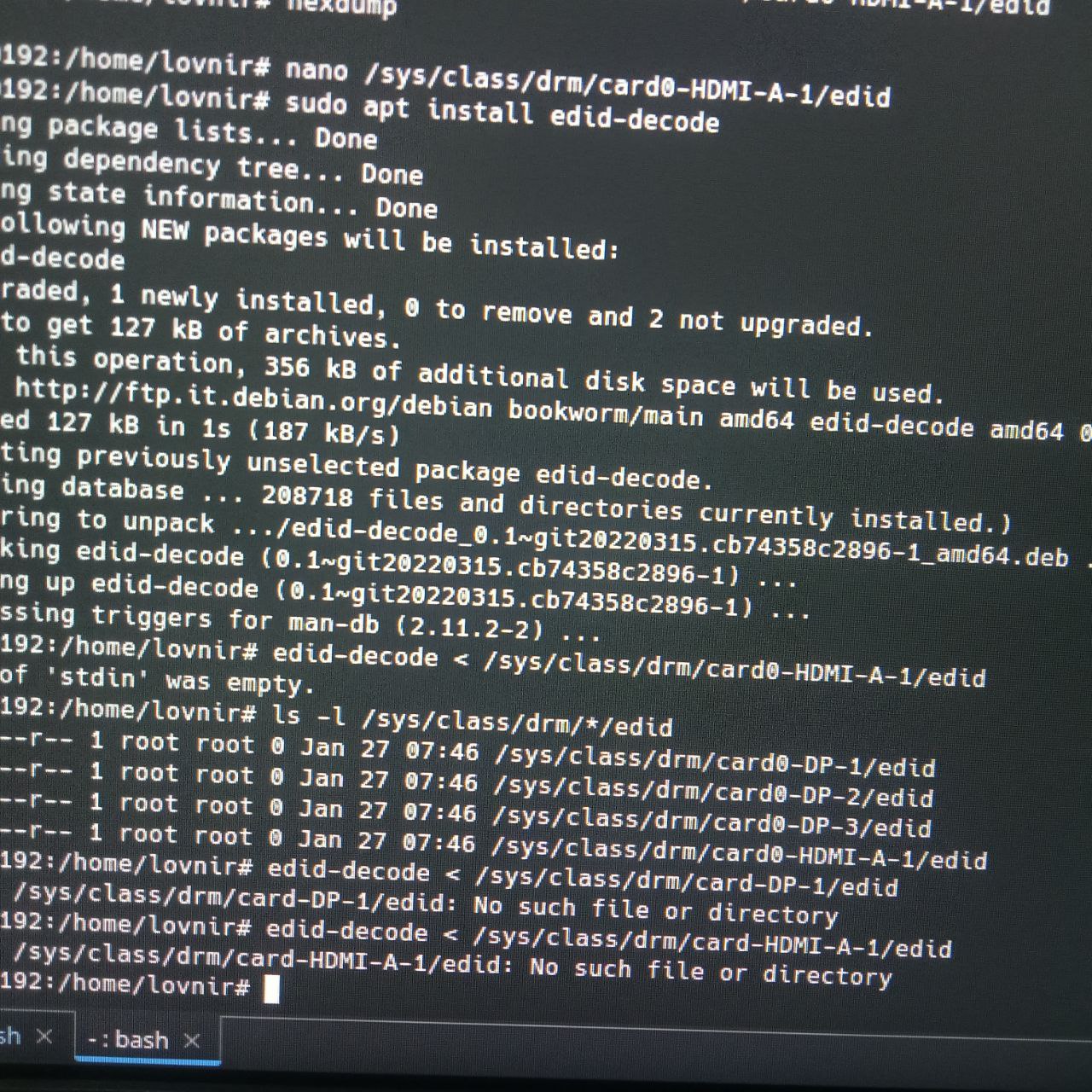

Also you might have different results with the Nouveau driver vs. NVIDIA's proprietary driver. NVIDIA's driver is less forgiving with EDID errors, so it might not detect the monitor if the EDID is corrupted.
If that doesn't work, the best option to confirm if the EDID is corrupted is to use EDWriter for Windows with an AMD GPU, which can read corrupted EDIDs directly from the monitor (read EDID and save to file): https://www.monitortests.com/forum/Threa...yID-Writer |

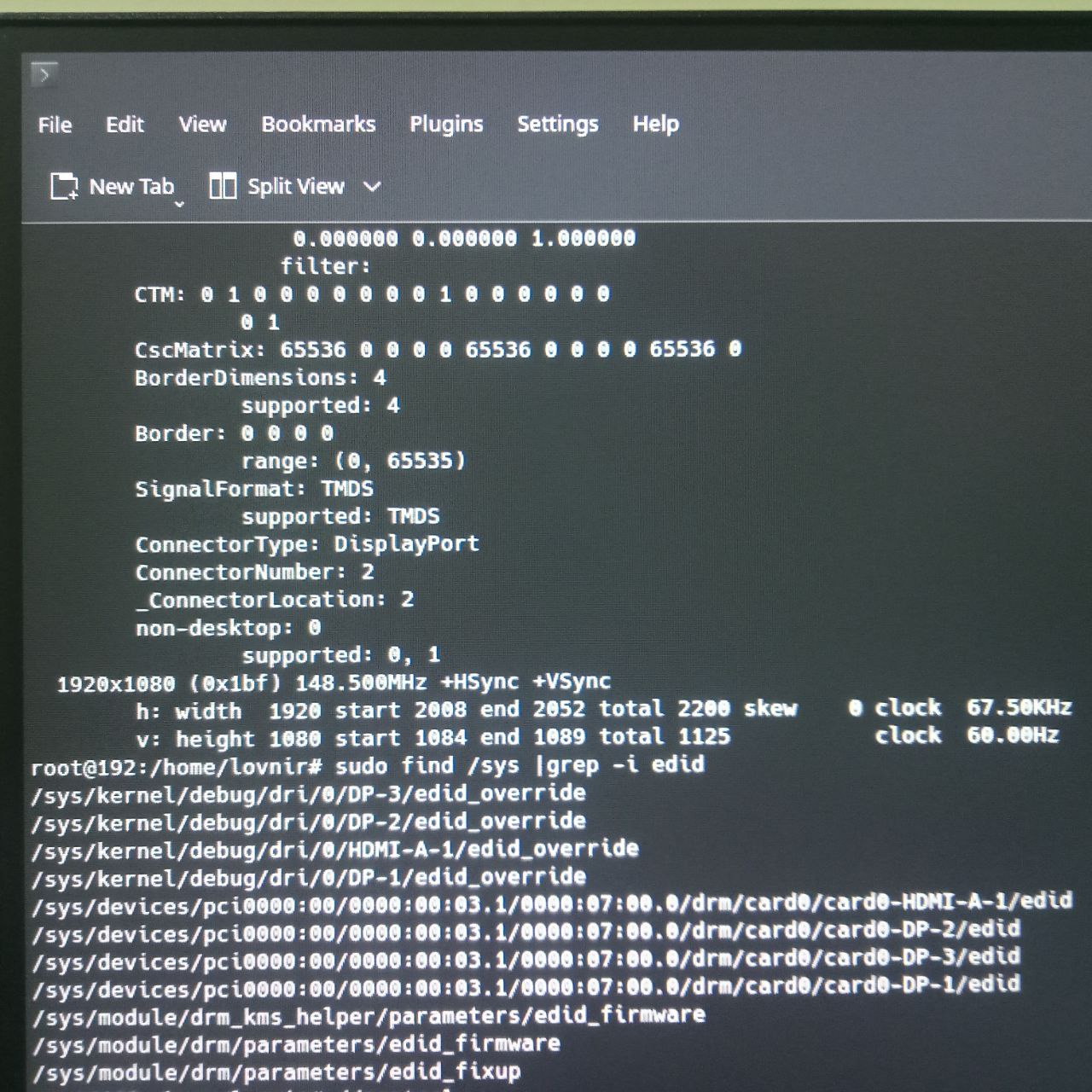

(01-27-2025 06:10 AM)ToastyX Wrote: Also you might have different results with the Nouveau driver vs. NVIDIA's proprietary driver. NVIDIA's driver is less forgiving with EDID errors, so it might not detect the monitor if the EDID is corrupted. you are correct it doesn't have any EDID sorry for reiterating to be concise after plugging it in during logon screen and unplugging vga adapter these are the screen shots, I can't open anything I had to enable the konsole shortcut then restart pc and do this no EDID given by monitor unfortunately don't have an AMD gpu wish I did in the first place, will update once I get EDID of the monitor on a different PC. what do you think is the easiest solution to this? hdmi to dp adapter would that even work with no EDID or buying a new gpu or new motherboard? where exactly is the issue to me it seems the monitor and gpu are incompatible. |
