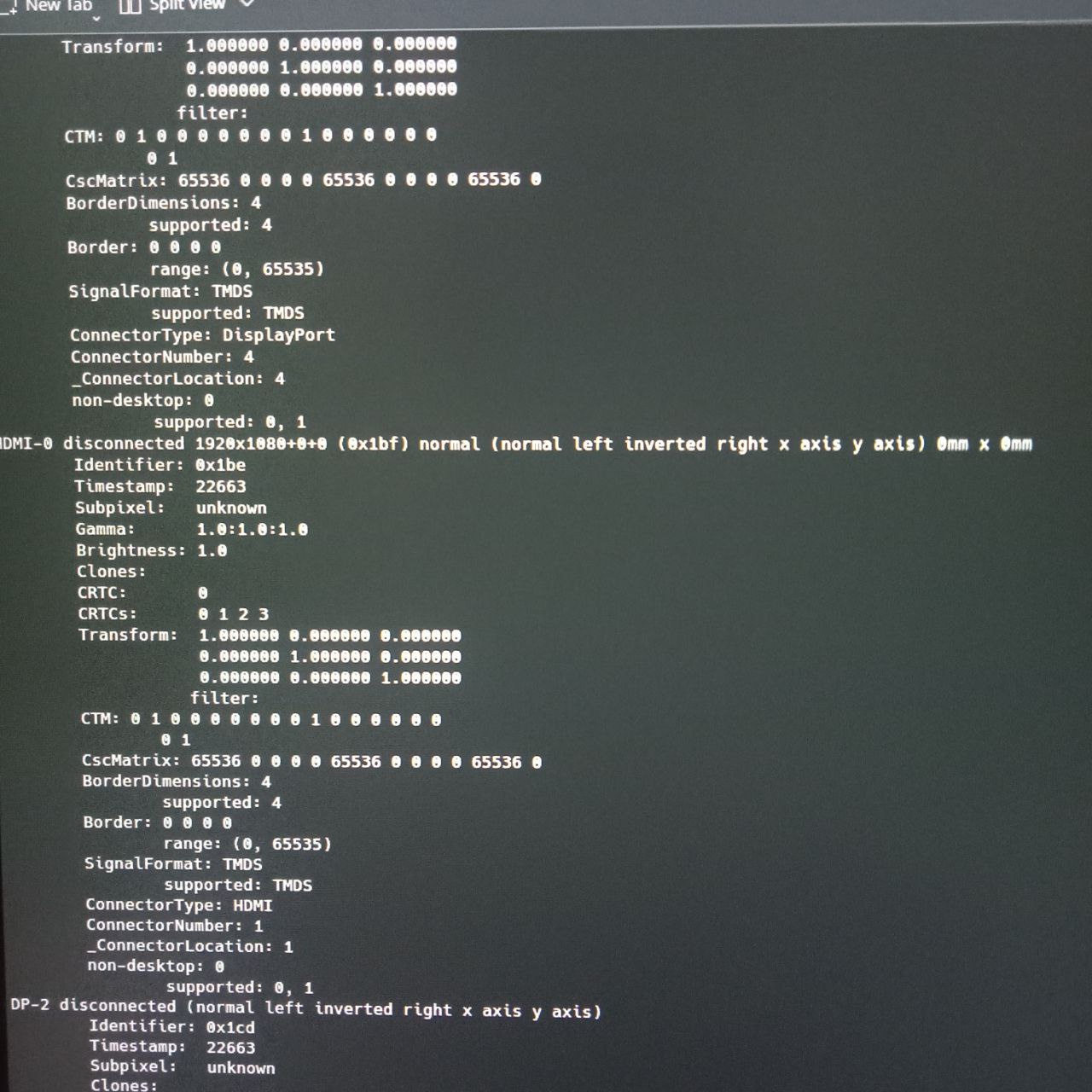

you are correct it doesn't have any EDID sorry for reiterating to be concise after plugging it in during logon screen and unplugging vga adapter these are the screen shots, I can't open anything I had to enable the konsole shortcut then restart pc and do this
no EDID given by monitor
unfortunately don't have an AMD gpu wish I did in the first place, will update once I get EDID of the monitor on a different PC.
what do you think is the easiest solution to this? hdmi to dp adapter would that even work with no EDID or buying a new gpu or new motherboard? where exactly is the issue to me it seems the monitor and gpu are incompatible.

(01-27-2025 06:33 AM)ovnir Wrote:  what do you think is the easiest solution to this? hdmi to dp adapter would that even work with no EDID or buying a new gpu or new motherboard? where exactly is the issue to me it seems the monitor and gpu are incompatible.
If the monitor has an invalid EDID, then you need to get it replaced. Don't try to work around a broken monitor. It's only a GPU issue if there's nothing wrong with the EDID. I need to see if there's anything wrong with the EDID to know for sure.
