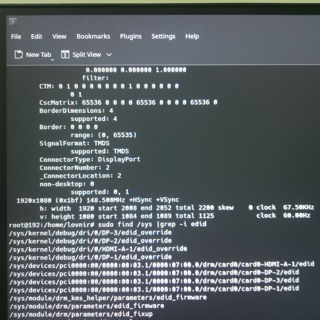

you are correct it doesn't have any EDID sorry for reiterating to be concise after plugging it in during logon screen and unplugging vga adapter these are the screen shots, I can't open anything I had to enable the konsole shortcut then restart pc and do this
no EDID given by monitor

If the monitor has an invalid EDID, then you need to get it replaced. Don't try to work around a broken monitor. It's only a GPU issue if there's nothing wrong with the EDID. I need to see if there's anything wrong with the EDID to know for sure.
