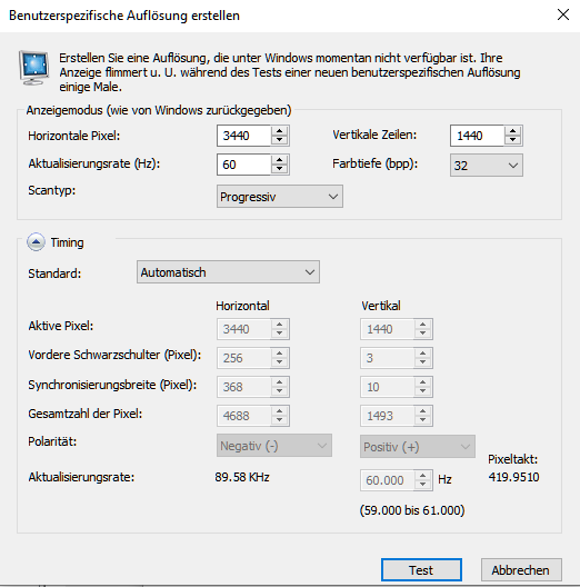

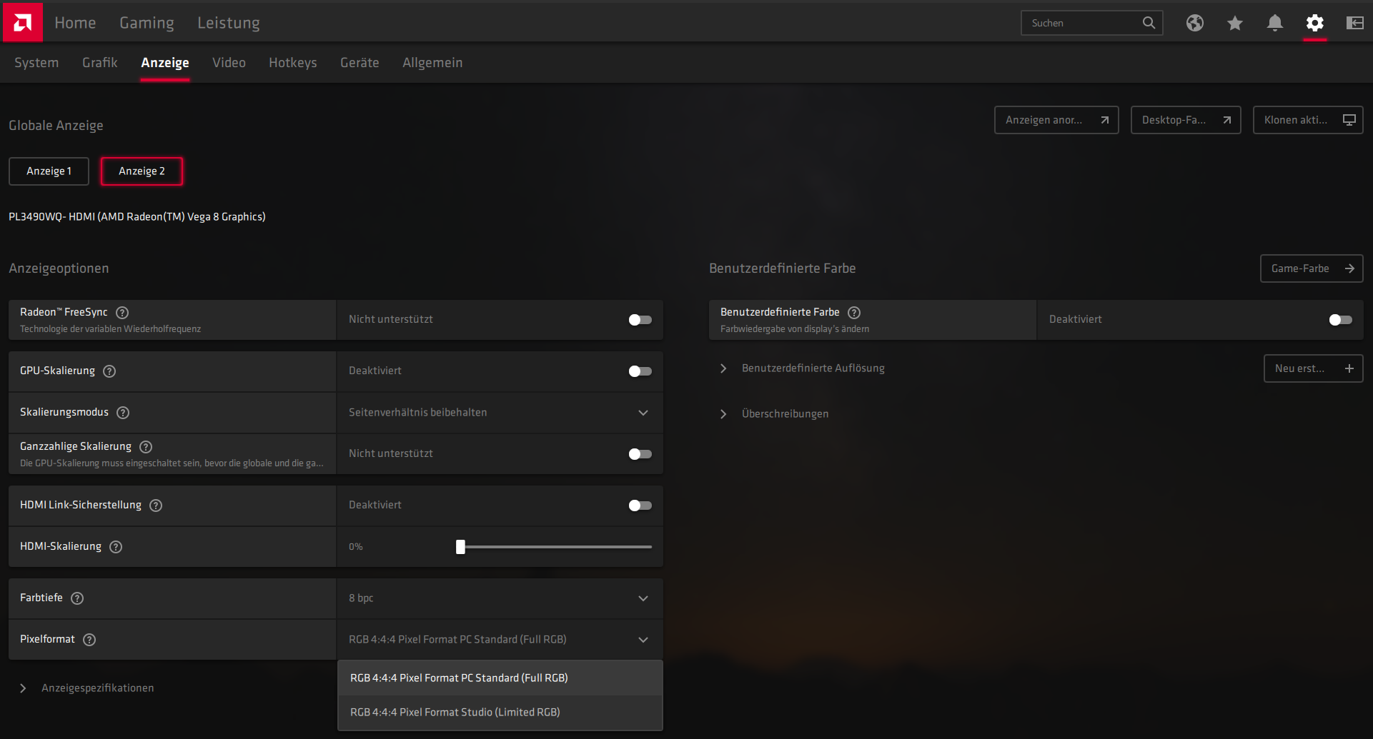

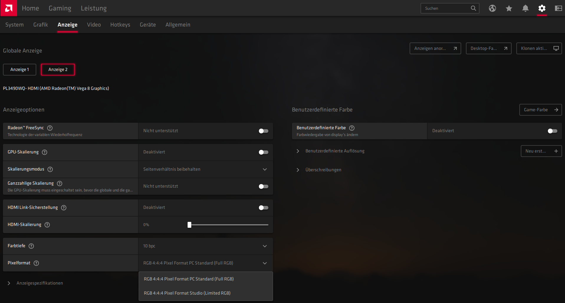

(04-25-2020 09:16 PM)Nintendo Maniac 64 Wrote:
(04-25-2020 10:31 AM)olco Wrote:  I am using the same input of the monitor and the same cable which works for my desktop pc, but I only get 30Hz.
Check that the color depth is set the same.
Similarly, what happens if you set a lower resolution, like 1920x1080 - are you then able to set it to 60Hz?
If you're able to successfully do that, then if worst comes to worst, you could always try setting the "pixel format" in your Radeon control panel to something like 4:2:2 or 4:2:0, in which case 60Hz may work...though your color resolution will be reduced (whether this is noticeable to you or not depends on various factors).
I can't set 1920x1080@60Hz as custom resolution. I get the same error message as when I am trying to set 3440x1440@60Hz as custom resolution.
I am not able to set subsampling to something different than 4:4:4 via the amd software. Even if I am setting 8bit colour instead of 10bit, there is still only 4:4:4 to set.
If I try to set all the timing options to the same values, that work for my 980ti on my desktop pc, I still get the same error message.
