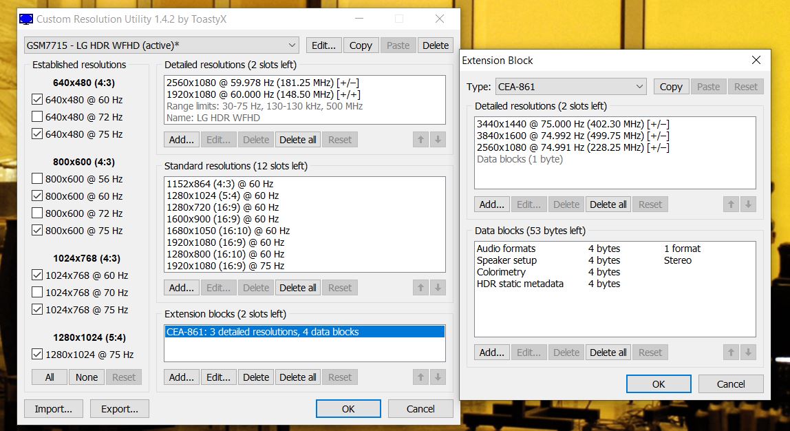

yep.kind of puzzled at why?I just follow the few steps in your OP but then after reboot back to 48/75Hz freesync range
[Image: Annotation-2020-07-29-221550.jpg]
thats what I set up in CRU and how it shows in RADEON drivers after rebootUndecided

(07-29-2020 12:54 PM)nolive721 Wrote:  yep.kind of puzzled at why?I just follow the few steps in your OP but then after reboot back to 48/75Hz freesync range
Are you using HDMI? With HDMI, you're supposed to edit the FreeSync range in the extension block. It's not supposed to show "Default extension block" either. Disable Eyefinity, and then run reset-all.exe and reboot. Make sure the extension block is readable before editing.

Yes 3monitors are hdmi but my VEGA GPU has DP ports so i use active convertor on each minitor
I can set each monitor fresync in the extension block while eyefinity is not yet created
After i set eyefinity then i open CRU to edit the freesync range but nothing is available in extension block except this defaut thing but no entry for freesync frequency

(07-29-2020 02:22 PM)nolive721 Wrote:  Yes 3monitors are hdmi but my VEGA GPU has DP ports so i use active convertor on each minitor
So it's creating separate monitor entries when Eyefinity is enabled? Then copy and paste the non-Eyefinity entries to the Eyefinity-enabled ones.

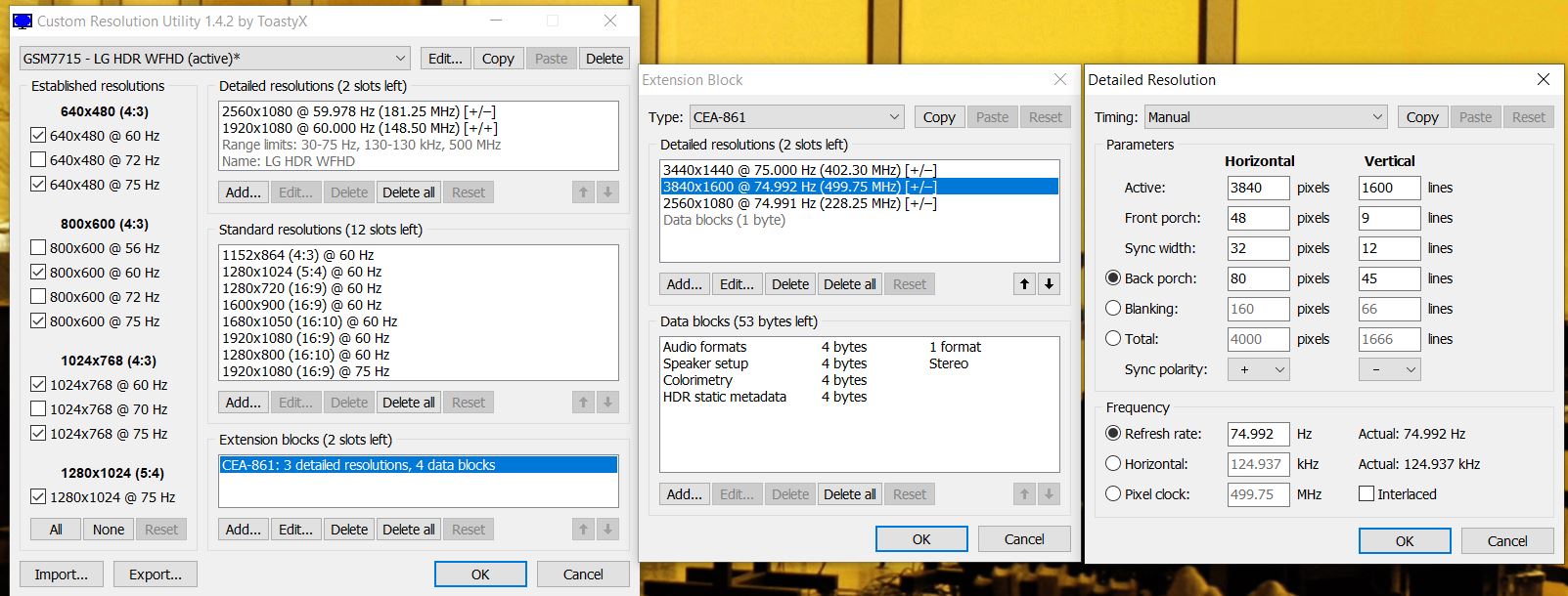

(07-19-2020 04:21 PM)ToastyX Wrote:  The blacking out sounds like a signal quality problem, or the monitor can't handle the resolution.
So... I just got myself a new DP cable, out of the box it just looked more "serious" than the one I was using, it's about 2 to 3 times thicker as well, but even so, I was still expecting it to behave just like the other (lower expectations, less frustrations xD).

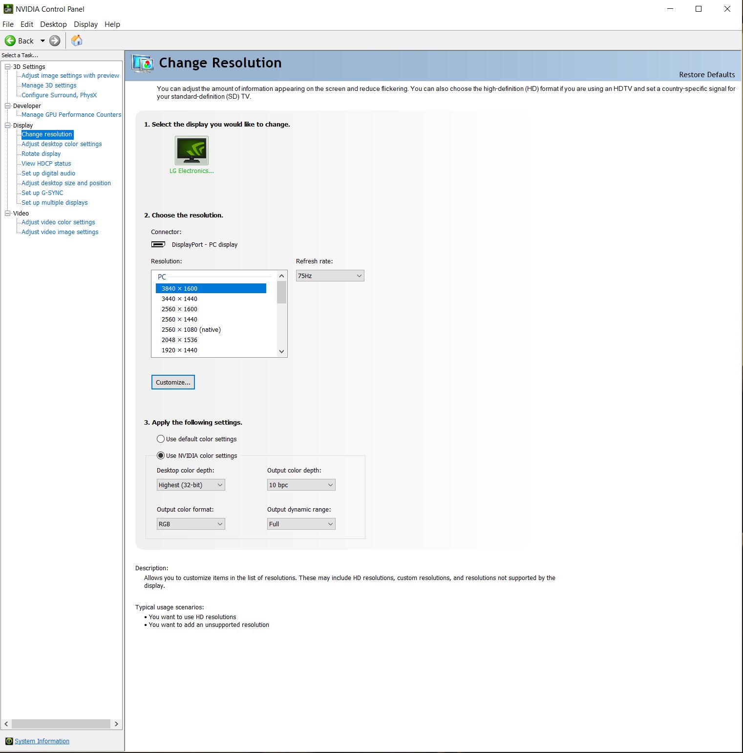

Except it didn't behave like before... first thing I notice is the post screen: it used to "glitch out" a little during post and boot, like flashing dots in the background, from day 1 using the previous cable, but when it loaded up the system the image would go perfect again. Well this time, the image is flawless during post and boot as well. Went to mess around with CRU again, 3440x1440 @ 75Hz and it works like a dream, no more flashing or image glitches, I was able to make it work on the 1st try!
Obviously I tried 3840x1600 @ 75Hz, and, oh my, it works as well... nVidia Panel says 10bit RGB, watched a few HDR movies and Youtube videos, played a couple of games, ran a few tests from TestUFO, and everything seems perfect so far.
Turns out you, Sir, were right indeed xD. Curiously enough, I ended up paying less for this new, much better cable, than I did on the previous one lol...
Thank you very much for your help, I really appreciate it.
Thanks again
Yes after creating the eyefinity group and strarting CRU there is one new entry that appears as active as you see in my snapshot
The monitor name is the one that i set as prefered display in the RADEON drivers user interface
