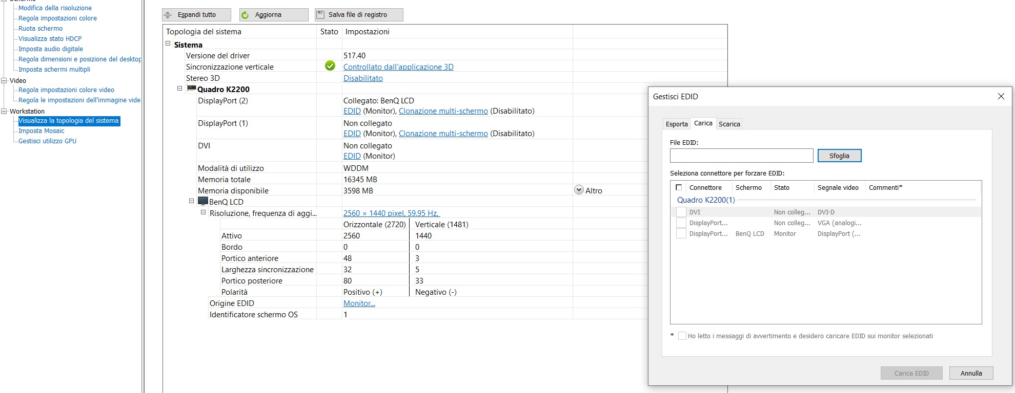

Thank you for the answer, I have already carried on a little.
Yes I'm on windows 10. The k2200 supports interlaced scanning from the DVD-I output (I'm using a DVI 24+5 to VGA adapter).
I already have feeded the SD CRT with all sort of resolutions (also years ago when I bought the UMSA), it never got any damage.

So, let's get to the point. Connecting the UMSA to the PC is like connecting nothing. The adapter is connected to the electric current and when connected to the CRT Tv it automatically change the input to AV1 (the source where it is connected), I cannot even change it. Unfortunately it doesn't seems to send anything to the PC for making it aware.
That's the main reason I never managed to make it work. But now on the quadro I get the workstation tab on nvidia control panel, see:
It is pratically a software EDID emulator. I can export a EDID, then import it on any input and windows recognizes it as a connected TV/monitor.
So I exported a couple EDID (from a HD-CRT Tv and a LCD Tv that should have PAL/NTSC standard res.) and the plan is to Edit it with CRU (making PAL or NTSC as the "first choice"/ native res), then load it on the DVI-I port while I'm using the display port monitor. Easy and safe (safe because when changing to monitor 2/UMSA if I don't get a correct picture on the CRT I'll just leave Windows to revert back).

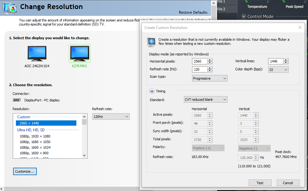

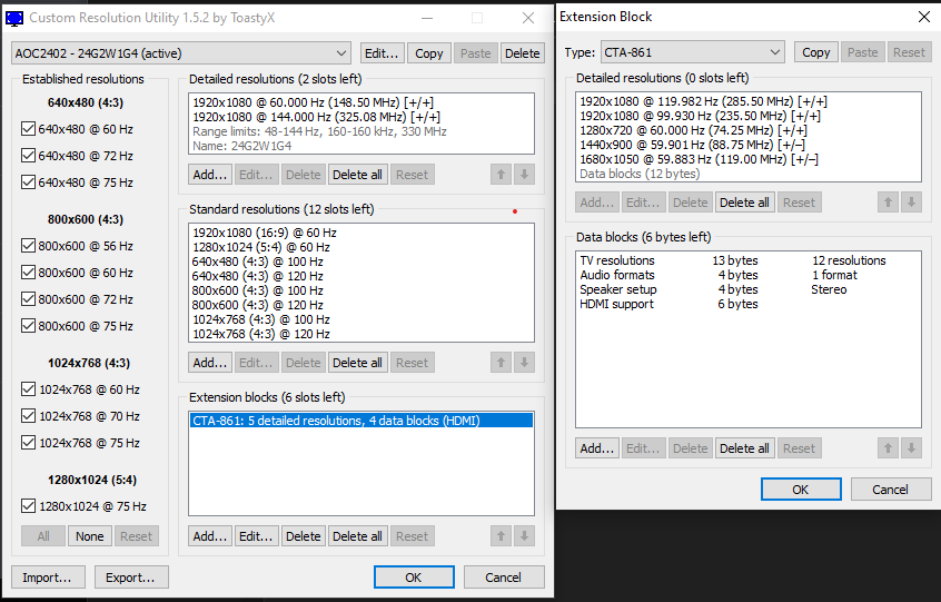

Hi Toast! Thanks so much for the detailed reply! So I tried the settings as per the screenshot, no problem when I changed the settings on the AOC display, even did a driver64 reset without issue. But the moment i change the settings for the prism+ display and do a driver64 reset, the entire PC freezes again. So I'm going to guess this is just signs that the PRISM+ monitor cannot be modified at all with CRU? Based on your experience, this is really a sign of the monitor issue or it's NVIDIA driver? Like idk how to find a good driver to test with haha.
By the way, not sure if this is the right way, but I just modified the values in the detailed resolution itself (so for the AOC, changing the 144Hz profile to a 119,584Hz profile as per your screenshot, and the PRISM+ one 59.950Hz to the 119.584Hz profile). Every paramter like front back proch etc, i follow exactly as per the screenshots too.
I also checked the standard resolutions + extension blocks, 1080p 120Hz doesn't exist in X270 pro. It does appear in the extension blocks for AOC monitor though
EDIT: I got it to work using NVIDIA'S panel's built-in custom resolution! This is the settings used, hope it helps us understand more what went wrong haha.
I want to say big thank you Toasty for your big support!

(10-01-2022 08:24 PM)Peppe90 Wrote:  About this, do you suggest to edit the EDID file, then load it on Nvidia CP, or should I load it first then EDIT with CRU while Windows is seeing it as a already connected monitor?
It would be better to load the modified EDID using the NVIDIA control panel because that's more direct. Too bad they only offer that for Quadro cards.

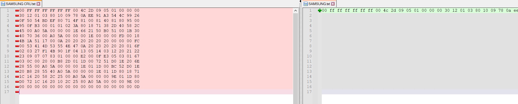

(10-01-2022 08:24 PM)Peppe90 Wrote:  I also noticed that exporting a EDID through Nvidia CP and CRU (both as TXT, since Nvidia CP only exports as TXT), the MD5 doesn't match.
Opening them on Notepad++ though, I see the values are the same but on CRU letters are uppercase and ordered in more lines instead of a long one. Perhaps this is enough for triggering a different MD5?
MD5 requires an exact match. The best way would be to compare the raw binary data, but the NVIDIA control panel only exports text files. The text formatting shouldn't affect the data as long as the hex values are the same.
