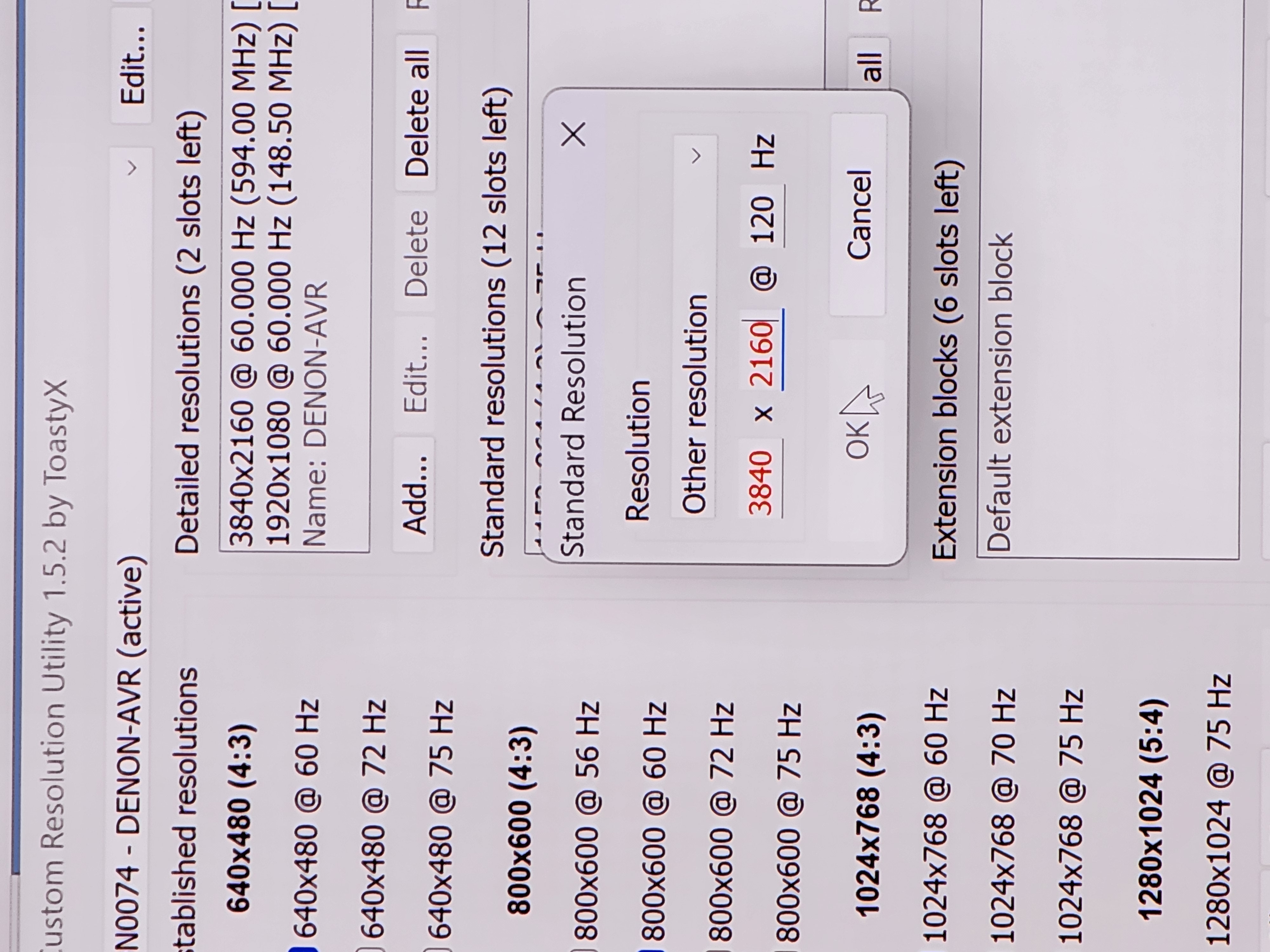

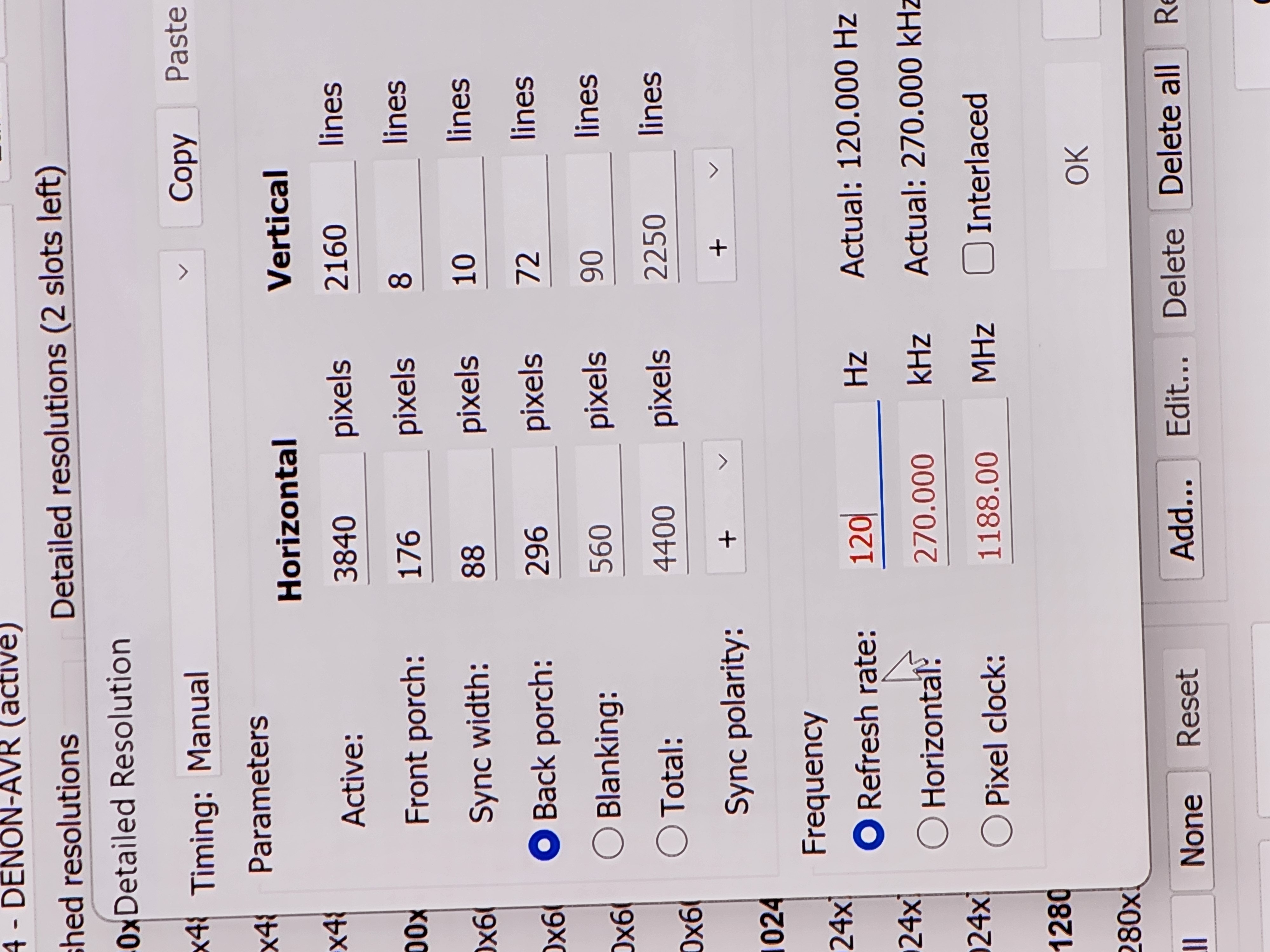

Okay. I have a weird one. With my samsung tv going through my receiver (so 4090 to receiver to tv) i can get 4k 120 on fresh driver install. However at some point after a few reboots it forces 4k 60. When that happens in the display adapter properties it shows my dsiplay native at 8k and I have no option for 4k 120; just 60. I cannot get this to show unless I set scaling in the ncvcp to display; not gpu. Once at scaling on display it is 4k 120. A clean ddu uninstall and reinstall f the driver allows 4k 120 but it bugs out after some amount of reboots.
Any idea how to fix this? If I open cru and try to create a 4k 120 it gives me red and won't allow anything but 4k 60. I am under the impression that gpu scaling is better so I would like to figure out how to make that option work.
Thank you for the help!

Just a note but it's a samsung 800b issue. Removing thr reciever and going to the tv direct still only allows 60 fps with gpu scaling. Is this expected behavior ? Any way to use cru to get 120 4k with gpu scaling?

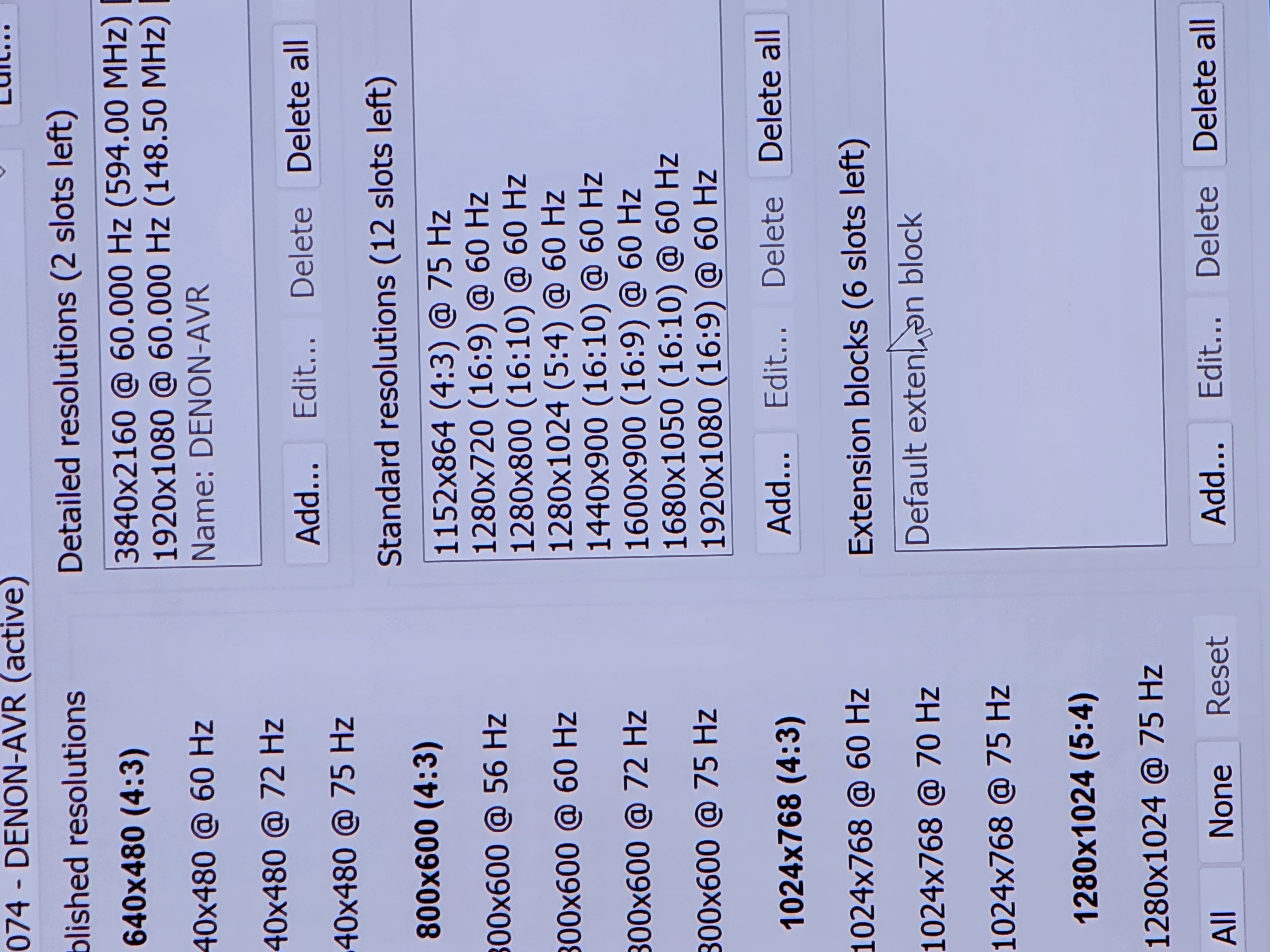

CRU is not for fixing problems like this. The TV already defines 3840x2160 @ 120 Hz, so there's no point in using CRU to add a resolution that already exists. The problem is you need HDMI 2.1 to get 3840x2160 @ 120 Hz. Both your computer and the dock only support HDMI 2.0.

Thanks Toasty. I think I probably confused it with several other posts claiming 3840x2160@120 using 4:2:2. 8b over HDMI 2.0.
[/quote]
I am in the process of attempting to connect DP1.4 from my dock to the C2 (DP to HDMI), once the cable arrives (HURRY UP AMAZON!).
I am also going to attempt USB-C to HDMI from either the USB-C on the laptop or the one on the WD19 dock.
The trick will be whether or not my Intel Iris Xe really outputs full DP1.4 on the USB-C ports.
This is one of the posts that originally got me thinking I could get 4K120 over HDMI 2.0. I think I was convinced that with CRU, I could make ONLY 420 8-bit color and 4k120 show up and sidestep my Intel Graphics Command Center which refuses to let me set custom resolutions.

(05-15-2023 02:07 AM)Travis5151 Wrote:  Just a note but it's a samsung 800b issue. Removing thr reciever and going to the tv direct still only allows 60 fps with gpu scaling. Is this expected behavior ? Any way to use cru to get 120 4k with gpu scaling?
GPU scaling scales to the native resolution, so if the TV's native resolution is 8K, the only way GPU scaling can work at 4K @ 120 Hz is if 8K @ 120 Hz is also available. The TV is designed to handle 4K @ 120 Hz, so you're better off just using display scaling.

(05-15-2023 02:42 PM)skola28 Wrote:  I am in the process of attempting to connect DP1.4 from my dock to the C2 (DP to HDMI), once the cable arrives (HURRY UP AMAZON!).
Yes, 4K @ 120 Hz is possible with YCbCr 4:2:0 but only if the GPU supports it. Also DisplayPort 1.4 has less bandwidth than HDMI 2.1, so using an adapter will only work if the GPU, dock, and adapter all support display stream compression (DSC).
