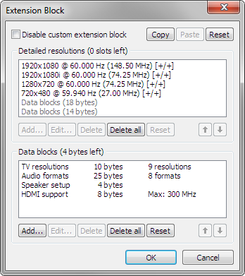

The TV probably defines a 300 MHz limit for HDMI in the extension block, so you have to override it with the hdmi-audio.dat file, or you can disable the extension block, but that will disable audio.
(01-30-2015 08:55 AM)toxsickcity Wrote:  Is it possible to have more than 4 custom resolutions in the top part of CRU?
The next version of CRU will let you create a custom extension block with up to 6 more detailed resolutions:
[Image: cru-teaser.png]
I've been working on custom extension block support for a while and hope to release it within the next two weeks.
