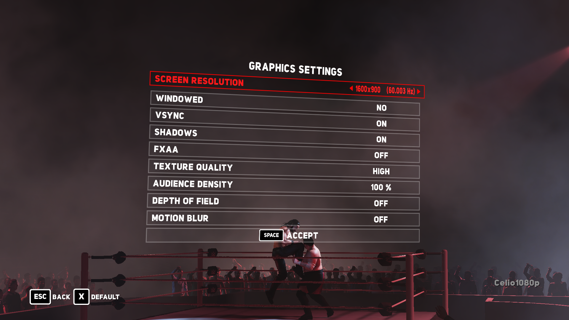

so, it's possible to force 60.000 Hz ? When i create a "Detailed resolution", the Hz always stays 60.002 Hz, on CRU. i use LCD Standard btw. i don't even know if that matters.. it's just a thing that i want to be sure that is normal.. Obs: my native resolution is 1600x900, when i set that resolution on CRU, the Hz is 60.002. (on WWE 2k18 game, it shows as 60.003.. i don't know why) When i create a custom resolution with Nvidia, i can set the 1920x1080 resolution to 60.000. (and all other resolutions above) Sorry my english. And thank you for CRU, awesome tool xD I uploaded some pictures. |

(08-15-2018 02:04 PM)CeLioCiBR Wrote: so, it's possible to force 60.000 Hz ?Horizontal Total × Vertical Total × Refresh Rate = Pixel Clock 1760 × 926 × 60 = 97,785,600 (97.7856 MHz) The problem is the pixel clock is limited to two decimal places, so CRU chooses the next highest possible value (97.79 MHz): Pixel Clock ÷ Horizontal Total ÷ Vertical Total = Refresh Rate 97,780,000 (97.78 MHz) ÷ 1760 ÷ 926 = 59.99656391125074 Hz 97,790,000 (97.79 MHz) ÷ 1760 ÷ 926 = 60.00269978401728 Hz You can get exactly 60 Hz by changing the vertical total to 925: 97,680,000 (97.68 MHz) ÷ 1760 ÷ 925 = 60 Hz |
