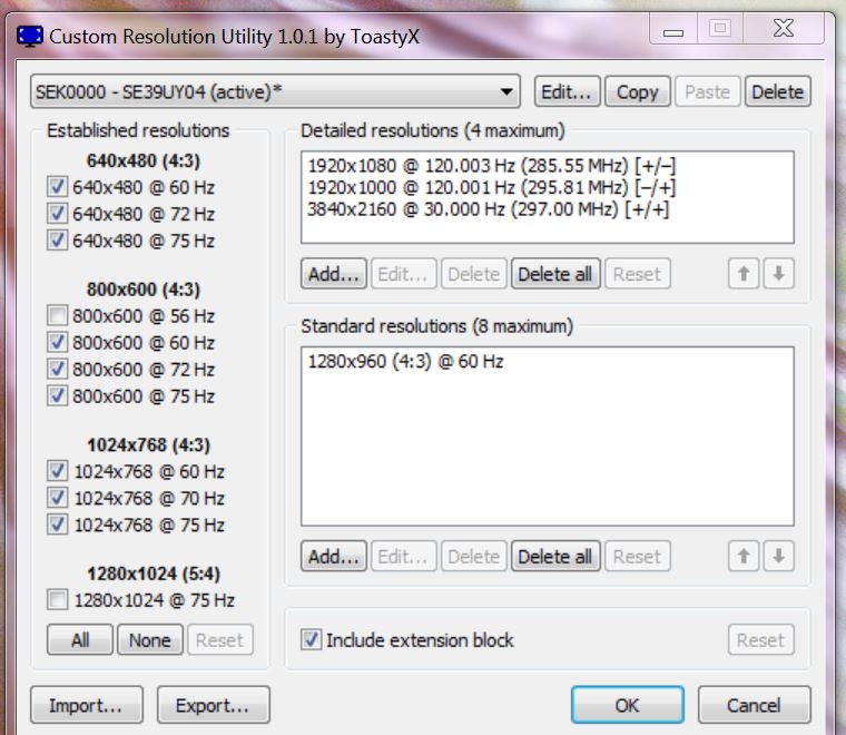

08-29-2013, 06:16 PM (Last edited: 08-29-2013, 06:19 PM by cardoski)
Post: #265
Wow great work and thanks for this application.
I have a amd hd 7970 and a Seiki 39in4k tv. I was able to make a custom resolution of 1980x1000@120hz. I tested it and it is 120hz, the tv says it is as well.It seems to be running fine in the desktop however when I try to game it goes black and when i play any video xbmc, youtube etc it goes green. I am sure you are aware but the unlike the 50in model this 39in model is only supposed to allow a 60hz input.Any help would be appreciated.Oh and when i made a resolution of 2560x1440@60hz everything was fine.
08-29-2013, 08:18 PM
Post: #266
(08-29-2013 06:16 PM)cardoski Wrote:  Wow great work and thanks for this application.
Ok i got the games to work by making a res of 1920x1080@120hz.Still the green screen for any video. I have to say once again good work.

Ok so I figured it out.I had the AMD Beta 13.8, I went back to 13.4 and all is well. Should have done that in the first place.lol
