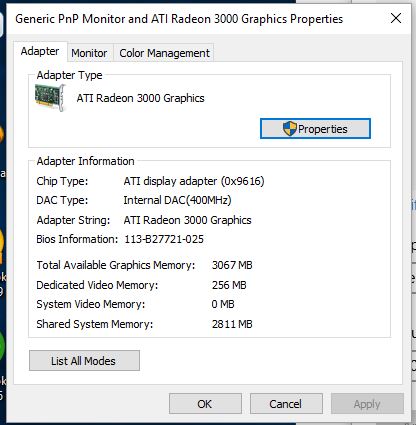

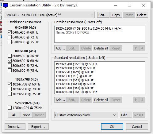

08-06-2016, 06:43 PM
Post: #2188
(08-06-2016 01:07 PM)ebaer Wrote:  I tried both of your suggestions, and although the settings were persisted, the values did not show up in the Display Adapter Settings in Windows 10.
I tried checking both before, and after rebooting.
The system is a Desktop (poorly named, as it sits on the floor) with an MSI 760GM-E51 FX Motherboard. It has an integrated graphics card. I am using both outputs it provides, 1 VGA, 1 HDMI.
Where are the files that are created by your program placed? Perhaps I could look there and see if the file is being overwritten/replaced. Or maybe on Windows 10 it is not updating the file that Windows 10 uses?
EDID overrides are stored in the registry. You can search for "EDID_OVERRIDE" using RegEdit. CRU reads the EDID information directly from the registry, so if the override was being removed or replaced, you would see the changes the next time you run CRU.
The fact that it says "(active)" and not "(restart required)" means the base block of the current EDID matches the EDID override, so the driver is reading the override but is ignoring it for some reason. Either the driver doesn't support EDID overrides for your GPU, or there's something wrong with the EDID sent by the adapter.
Run reset-all.exe and then restart.exe. Then use MonInfo to save the full "real-time" EDID for the SNY monitor to a .bin file: http://www.entechtaiwan.com/util/moninfo.shtm
Then post the file here so I can see if there's anything wrong with the EDID.
