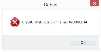

11-05-2013, 08:42 AM
Post: #214
Hi toasty,
Thank you for all your hard work on this.
I cannot get the patcher to work. win8.1preview 7950
After patching it says signing failed. Ive tried both test mode and not test mode.
On reboot the screens will not come back on. I have to go into safe mode and run the patcher and restore previous drivers.
I have tried this on 13.10 and 13.11betav8
11-05-2013, 05:08 PM
Post: #215
(11-05-2013 08:42 AM)rcoolb2002 Wrote:  I cannot get the patcher to work. win8.1preview 7950
Try renaming or deleting the folder under %APPDATA%\Microsoft\Crypto\RSA. Then patch the driver again.
11-08-2013, 04:19 AM
Post: #216
Still getting the driver could not be signed error.
11-08-2013, 02:30 PM
Post: #217
(11-08-2013 04:19 AM)rcoolb2002 Wrote:  Still getting the driver could not be signed error.
What error code are you getting?
11-08-2013, 07:50 PM
Post: #218
(11-05-2013 05:08 PM)ToastyX Wrote:  What error code are you getting?
Chronological order.
11-09-2013, 04:50 PM
Post: #219
Nobody has ever reported that error code. I don't know what could possibly cause that.
Try this older version that requires test mode: https://www.monitortests.com/atikmdag-patcher-1.1.2.zip
If that gives you the same error, then I don't have a solution. Something is unusual about your system.
11-10-2013, 08:00 AM
Post: #220
(11-09-2013 04:50 PM)ToastyX Wrote:  Nobody has ever reported that error code. I don't know what could possibly cause that.
I was successfully able to patch with 1.1.2
It did however crash my HD4000 driver, but a simple uninstall reinstall seems to have fixed that. HD4000 + AMD is bugged with windows 8.1 anyways.
