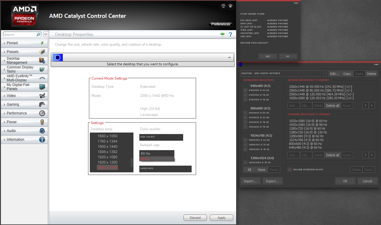

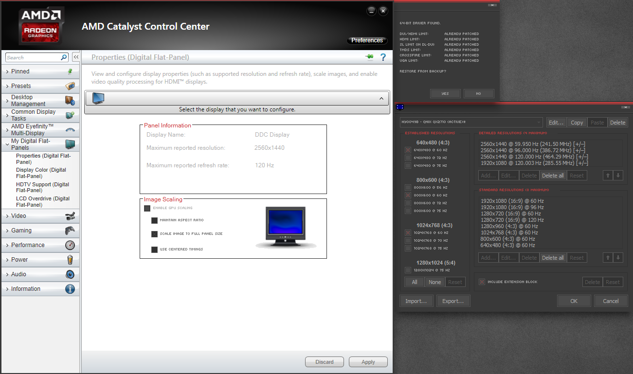

Hey Toasty, thank you for your continouos work on this patch.
I have just updated my graphics drivers from 13.9 to 13.12 and am experiencing problems, although I'm unable to completely pin down their origin.
With driver version 13.9 and a 1.1 version of your patch I was able to run my QNIX QX2710 on 2560x1440@120Hz just fine.
Now that I've updated to 13.12 and applied the most recent version of the patch, it reports that it patched all the limits, but I am still unable to select the custom resolutions I created with CRU.
I've already tried completely removing all AMD drivers from my PC, rebooting, then reinstalling them, then rebooting again before applying the patch, still, the result wasn't different.
I've also reset all EDID's using CRU, rebooted and then configured the monitor's again, still, in vain.
Even disabling avast! during patching, attempts to set the refresh rate using DisplayFusion and enabling/disabling testmode and rebooting did not help with this.
The Catalyst Control Center even reports the monitor at a max. resolution of 2560x1440@120Hz, but I just can't seem to apply it.
I have attached two screenshots showing the CCC, the patcher and CRU; I hope you can help me in some way.

Use the arrow buttons to order the refresh rates from highest to lowest, and remove all the non-2560x1440 resolutions because that monitor can't handle them. Enable GPU scaling if you want to use lower resolutions. The extension block should also be disabled because the monitor doesn't actually have one, but that shouldn't make a difference with AMD cards.

(01-12-2014 04:20 AM)ToastyX Wrote:  Use the arrow buttons to order the refresh rates from highest to lowest[...]
Thank you very much, this method worked.
Now I'm only able to select 120Hz as the refresh rate, but that doesn't really bother me, as it is the only one I'd use anyway.
Although I am unable to activate GPU scaling in any way, I can select it and apply it, but it just reverts itself directly.

(01-12-2014 10:45 AM)CheddarCheese Wrote:  Now I'm only able to select 120Hz as the refresh rate, but that doesn't really bother me, as it is the only one I'd use anyway.
That's really weird. Did you delete 1920x1080 @ 120.003 Hz? 2560x1440 @ 120 Hz needs to be listed first and not 1920x1080 @ 120.003 Hz.
You shouldn't need to add any lower resolutions. 1920x1080 and other standard resolutions should be available as scaled resolutions even if you don't add them.
AMD's driver is really weird about GPU scaling. You have to switch to a lower resolution to set it, and sometimes the setting won't stick with certain resolutions.
