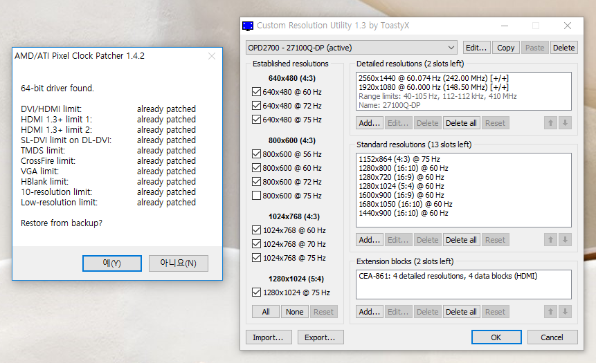

Cannot support DP? I want use FreeSync with Overclocked hz, but FreeSync support only DP (I using 2560*1440 Resolution). So I can't use that.

(11-27-2016 08:18 AM)Altberta Wrote:  Cannot support DP? I want use FreeSync with Overclocked hz, but FreeSync support only DP (I using 2560*1440 Resolution). So I can't use that.
The patch is for pixel clock limits. What pixel clock limits are you seeing with DisplayPort?
I want overclock 75hz to 100hz. It can be using DVI, but DP can't because range limit is still exist after clock patch.
[Image: attachment.php?aid=214]
11-28-2016, 12:52 PM
Post: #689
(11-28-2016 07:57 AM)Altberta Wrote:  I want overclock 75hz to 100hz. It can be using DVI, but DP can't because range limit is still exist after clock patch.
You shouldn't need the patch to get 100 Hz with DisplayPort. The range limits have nothing to do with the patch. It's required for FreeSync. What happens when you add 100 Hz? Show me what you did. Export a file so I can see the complete configuration.
I did attach configuration files. Default/Patched DVI/DP export bin files and Patched DVI/DP screenshots.
.zip  Altberta.zip (Size: 206.41 KB / Downloads: 911)
