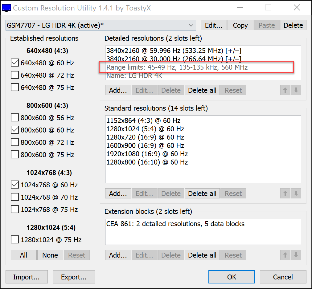

01-17-2019, 11:06 PM
Post: #3736
Hello, I have a problem with my tv and windows hdr. Windows can't detect color primaries information from TV and works with own Color Primaries: Red(0.659180,0.339844), Green(0.244141,0.669922), Blue(0.129883,0.040039), White Point(0.312500,0.329102)
That default color space doesn't match DCI-p3 and doesn't match real color space of my TV. SO red color doesn't look saturated as intended because 0.659180,0.339844 is worse than 0.68, 0.32.
Is there any way to everwrite these values for windows HDR(can be checked by VESA test program)?

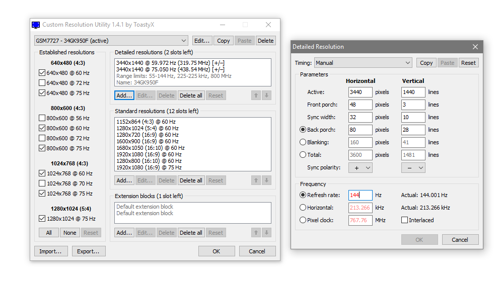

01-18-2019, 10:29 PM (Last edited: 01-18-2019, 10:30 PM by rayw_cru)
Post: #3738
ToastyX Wrote:Literal God
Hi @ToastyX,
Fantastic work on CRU, I've been a follower for several years now but haven't registered and posted until now. Kudos Smile
Would like to report a potential bug: I recently got an LG 34GK950F and noticed that CRU doesn't show any of the higher refresh rates, nor a FreeSync range entry in the extended block.
It also doesn't let me add a custom entry with the native 3440x1440@144Hz resolution (attached screenshot of CRU 1.4.1).
I am happy to report that I can use FreeSync on this monitor with an NVIDIA GPU just fine thanks to NVIDIA finally caving in and supporting Adaptive Sync.
