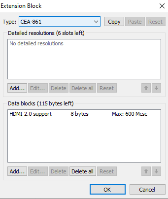

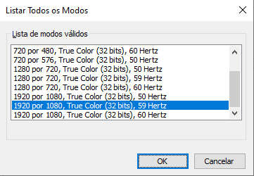

(10-23-2020 12:57 AM)ToastyX Wrote:(10-23-2020 12:20 AM)LLopesx Wrote: Thanks, i did what you said and worked well, but now i don't know how to put more refresh rate than 60hz, there is no option on windows, you saved my day thanks broYou'll have to add an HDMI 2.0 data block in the extension block (defaults are fine). Tried that and i think it didn't work And i tried to add a resolution in the extension block and 120hz worked but when i tried to enable freesync the refresh hate changed to 60hz :/ |

(10-23-2020 02:15 AM)ToastyX Wrote:(10-23-2020 01:50 AM)LLopesx Wrote: Tried that and i think it didn't workYou are missing the HDMI support data block. You need both HDMI and HDMI 2.0. Now it worked 120hz with freesync, thanks ToastyX you're a god, thanks for your time helping me, someday i pay a coffee for u, and just to know there's a way to put on 144hz with hdmi? |

Post: #5196
(10-23-2020 02:31 AM)LLopesx Wrote: Now it worked 120hz with freesync, thanks ToastyX you're a god, thanks for your time helping me, someday i pay a coffee for u, and just to know there's a way to put on 144hz with hdmi?Normally laptops with Intel GPUs only support up to 300.99 MHz pixel clock with HDMI, which isn't enough for 1080p @ 144 Hz, but then 3840x2160 shouldn't have worked unless it was 30 Hz or YCbCr 4:2:0, so I don't know. |

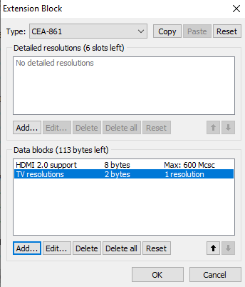

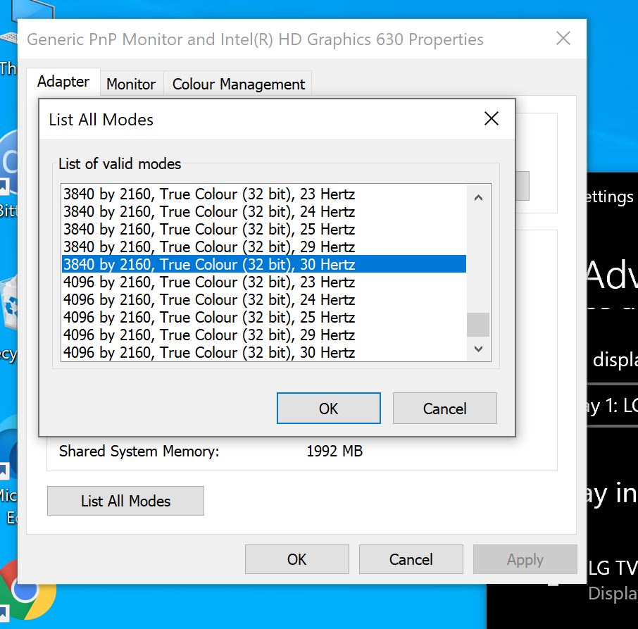

(10-23-2020 12:58 AM)ToastyX Wrote:(10-22-2020 03:58 PM)slobo2712 Wrote: Hi everyone, I have LG 43UK6300PLB TV , Intel CPU G4620 , Gigabyte B250M-DS3H with 1.4 HDMI out.Im interested if there is any chance to set up 4k60hz 4:2:0 resolution with this configuration.I have tried everything with this utillitu but 4k60hzso you'll have to delete any default extension blocks and create one manually. Tnx for answer,do you mean to delete default extension blocks with CRU or find somewhere else in files? |

(10-23-2020 03:47 AM)slobo2712 Wrote: Tnx for answer,do you mean to delete default extension blocks with CRU or find somewhere else in files?Yes, delete the default extension block with CRU. Why do you have three extension blocks? Why did you delete the detailed resolutions? Where is the HDMI data block that I told you to add? You need one extension block with HDMI support and 4:2:0 resolutions. You need one detailed resolution to define the native resolution. |
