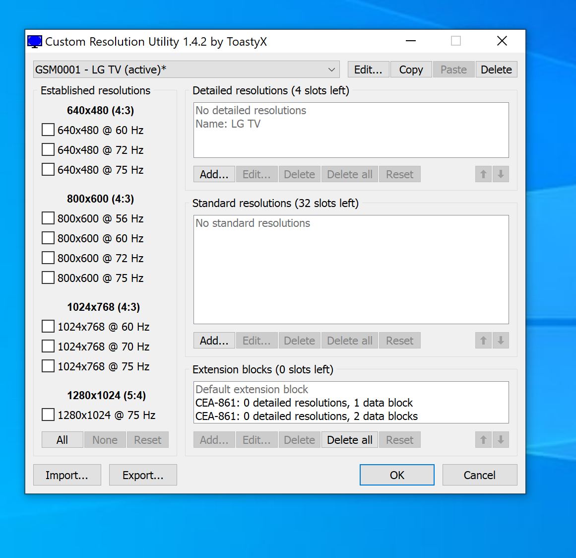

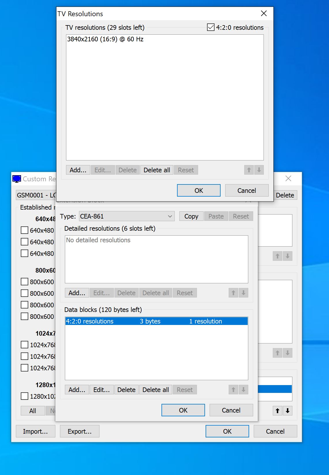

(10-22-2020 03:58 PM)slobo2712 Wrote:  Hi everyone, I have LG 43UK6300PLB TV , Intel CPU G4620 , Gigabyte B250M-DS3H with 1.4 HDMI out.Im interested if there is any chance to set up 4k60hz 4:2:0 resolution with this configuration.I have tried everything with this utillitu but 4k60hz
just doesnt show up in resolutions ..I know that hdmi 1.4 is limited to 4k30 but is it possible to do this ?https://www.tomshardware.com/amp/news/nvidia-kepler-4k-hdmi-1.4,27117.html Tnx in advance
so you'll have to delete any default extension blocks and create one manually.

(10-23-2020 03:47 AM)slobo2712 Wrote:  Tnx for answer,do you mean to delete default extension blocks with CRU or find somewhere else in files?
Yes, delete the default extension block with CRU. Why do you have three extension blocks? Why did you delete the detailed resolutions? Where is the HDMI data block that I told you to add? You need one extension block with HDMI support and 4:2:0 resolutions. You need one detailed resolution to define the native resolution.
