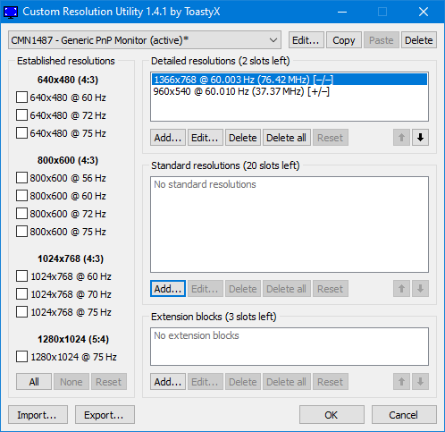

09-26-2020, 10:49 PM (Last edited: 09-28-2020, 08:57 AM by heaae)
Post: #5135
PROBLEM WITH NOT PERSISTENT SETTINGS
I've noticed that since I installed Windows 10 2004 some months ago, it "looses" CRU custom settings much more easily than before when they lasted 'till next NVidia driver update... Now my CRU custom res sometimes randomly just disappear and I have to relaunch CRU + restart64.exe. Someone knows why and if there's a "solution" to make custom settings more persistent?
Basically every day I have to reload CRU + Restart64.exe to make my custom res reappear. There was a time when I just set it once and lasted 'till the day I changed video driver. Now for unknown reasons after a night sleep+hibernation the system looses my custom res. If I do sleep or hibernation manually for testing this does not happen and CRU custom res are still there....
EDIT:
Another strange thing I noticed is that I have 2 monitors listed in CRU and in the registry (??), that differ just for "Address" and "ContainerID" values:
[Image: image.png]
EDIT2: from Device Manager (show hidden devices option) I deleted the strange one "1&8713bca&0&UID0". Let's see if this helps...
(Attached my CRU settings)

09-29-2020, 08:39 AM (Last edited: 09-29-2020, 08:46 AM by heaae)
Post: #5138
(09-26-2020 10:49 PM)heaae Wrote:  PROBLEM WITH NOT PERSISTENT SETTINGS
EDIT:
[Image: image.png]
Gaming Laptop ASUS GL703GS (BIOS 310)
CPU i7-8750H (iGPU unavailable)
GTX 1070 8GB (non-Max-Q, 10DE 1BE1 - 1043 1011, GP104 A1, vbios 86.04.7c.00.24, Samsung VRAM)
Windows 10 Pro 2004
Desktop res: 1080p (1920x1080)
Screen: 144Hz g-sync AUO B173HAN03.2 [AUO329D]
Audio: Realtek HD Audio (ALC295 chipset)
Hard disks: NVMe Samsung, SSD Crucial
USB Blu-Ray 4K drive: Archgon Star MD-8102P-U3YC-UHDB (Pioneer BDR-UD04)
No way. Once again, after overnight sleep + hibernation, CRU custom res disappeared again Sad
NVidia driver 452.06 WHQL
...and once again Windows re-created the ghost monitor "1&8713bca&0&UID0" (!?)

10-01-2020, 03:19 PM
Post: #5140
(09-29-2020 08:39 AM)heaae Wrote:  No way. Once again, after overnight sleep + hibernation, CRU custom res disappeared again Sad
That's not normal, and I can't think of what would cause that. I don't think it's an NVIDIA driver bug because it wouldn't delete the EDID override. Even installing a new driver shouldn't delete the EDID override unless you're using DDU to wipe everything first.
Maybe the computer is crashing while hibernating so the settings are reverting to the last booted configuration. Have you tried rebooting instead of running restart64.exe?
The "ghost" monitor is not a problem. That gets created when restart64.exe restarts the graphics driver.
