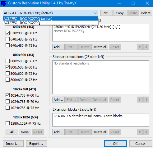

10-31-2020, 10:15 PM (Last edited: 10-31-2020, 10:21 PM by botounacruzeta)
Post: #5260
(10-31-2020 08:57 PM)ToastyX Wrote:  Don't import anything. Just run reset-all.exe and restart. Then enable the range limits and serial number. Does that work? Then try deleting the resolution from the extension block.
I've tried this.
If I run:
-reset-all.exe;
-restart GPU;
-only enable the range limits and serial number in CRU;
-restart GPU;
Then NVCPL doesn't work.
I noticed something in CRU I don't understand: it shows the monitor two times. (see attached picture, that corresponds to clean default settings). I don't know if it's due to GSYNC module, or if it's normal for every monitor. (There's only one monitor plugged to my PC).
Anyway, I tried to enable and disable the range limits and serial number also for this "second" monitor, but it doesn't help.
