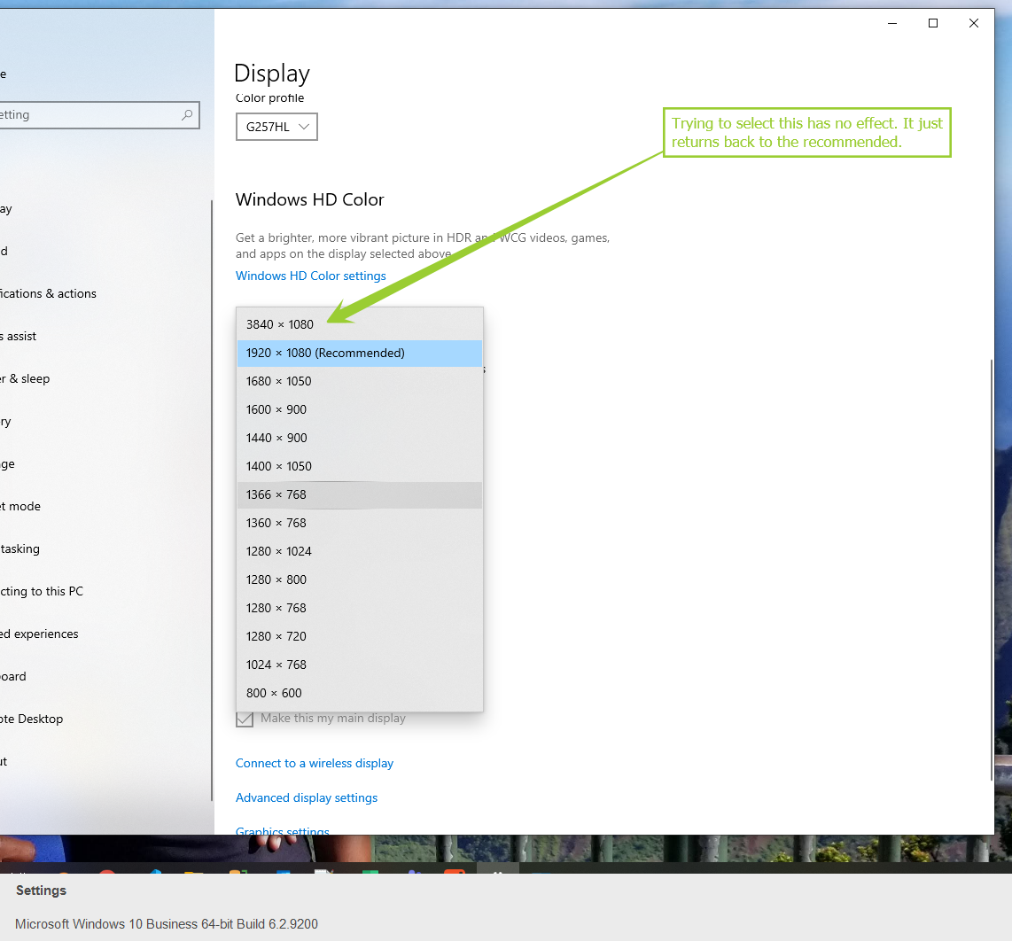

Hey Toasty. Are you still maintaining this CRU software?
My computer is running Win 10 and I downloaded and ran your CRU software. I have 4 monitors, but just 3 HDMI ports on my laptop & docking station combined. I bought a HDMI splitter to attach to the HDMI port on my laptop directly and then tried to use the CRU software to increase the resolution from 1920 x 1080 to 3840 x 1080 for the main monitor so that I could use two of the monitors as one off the splitter. The resolution option shows in the Display Resolution dropdown, but whenever I try to select it, it just returns to 1920 x 1080. (see attachment) Please help. I've restarted and I ran the restart.exe with no effect. Sean |

(01-22-2021 05:22 PM)sjohnson Wrote: Hey Toasty. Are you still maintaining this CRU software?Yes, I just released 1.5.1 four days ago. (01-22-2021 05:22 PM)sjohnson Wrote: I bought a HDMI splitter to attach to the HDMI port on my laptop directly and then tried to use the CRU software to increase the resolution from 1920 x 1080 to 3840 x 1080 for the main monitor so that I could use two of the monitors as one off the splitter.That can only be a driver bug. There's no reason for a resolution to be listed in the display settings if it can't be selected. Splitters are for displaying the same image on two monitors. I don't see how sending 3840x1080 to both monitors would work the way you want. |

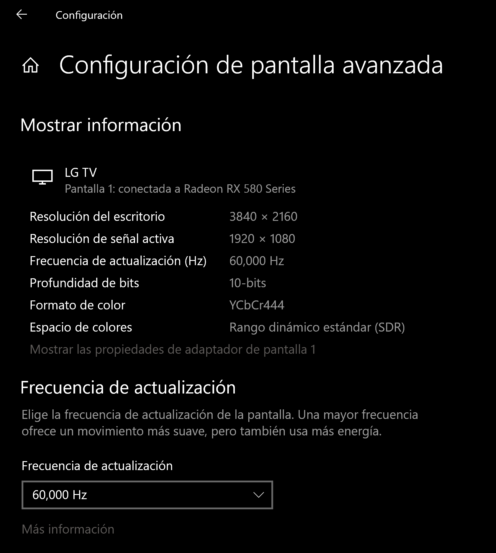

Hi ToastyX.
Thank you very much for your free software. You gave a new life to my LG 32 TV from 2013, thank you. I find your CRU program wonderful. I have read a lot but one thing is not clear to me, I have an RX580 with HDMI 2.0 output, the HDMI cable is 2.1 and the TV is HDMI 1.4B. The question is if I leave the TDMS at 340 if what commands is the limitation of the HDMI1.4B of the TV, or sends the HDMI 2.0 of the RX. It lets me add the HDMI 2.x block and it doesn't give me a problem, but if I limit the 1.4b to 340, doesn't it make sense to set the TDMS to 600? Thank you very much and greetings. |

(01-25-2021 01:40 PM)dieg0 Wrote: I have read a lot but one thing is not clear to me, I have an RX580 with HDMI 2.0 output, the HDMI cable is 2.1 and the TV is HDMI 1.4B.The HDMI 1.4 spec doesn't support more than 340 MHz, and HDMI 2.0 uses the maximum character rate in the HDMI 2.0 data block, which is normally 600 Mcsc, so the maximum TMDS clock doesn't need to be set to 600 MHz. Changing the values only tells the driver what the TV supports. It doesn't send any commands to the hardware. |
