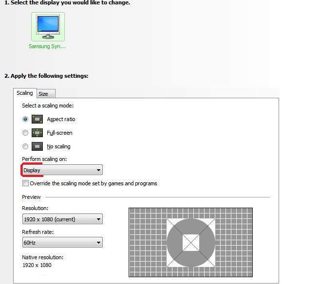

Hey Toasty, can you manage to make it possible to use option "Perform scalling on monitor" in Nvidia Contol Panel when using custom resolutions from CRU?
If I create custom resolution, it's only showing GPU in Nvidia Control Panel's scalling options

(01-24-2021 11:47 AM)imperialismus Wrote:  Hey Toasty, can you manage to make it possible to use option "Perform scalling on monitor" in Nvidia Contol Panel when using custom resolutions from CRU?
Display scaling is supposed to be available if there are any non-native resolutions, but something is screwed up with NVIDIA's scaling logic because it's sometimes not available when it should be, and I haven't figured out what conditions make it available.

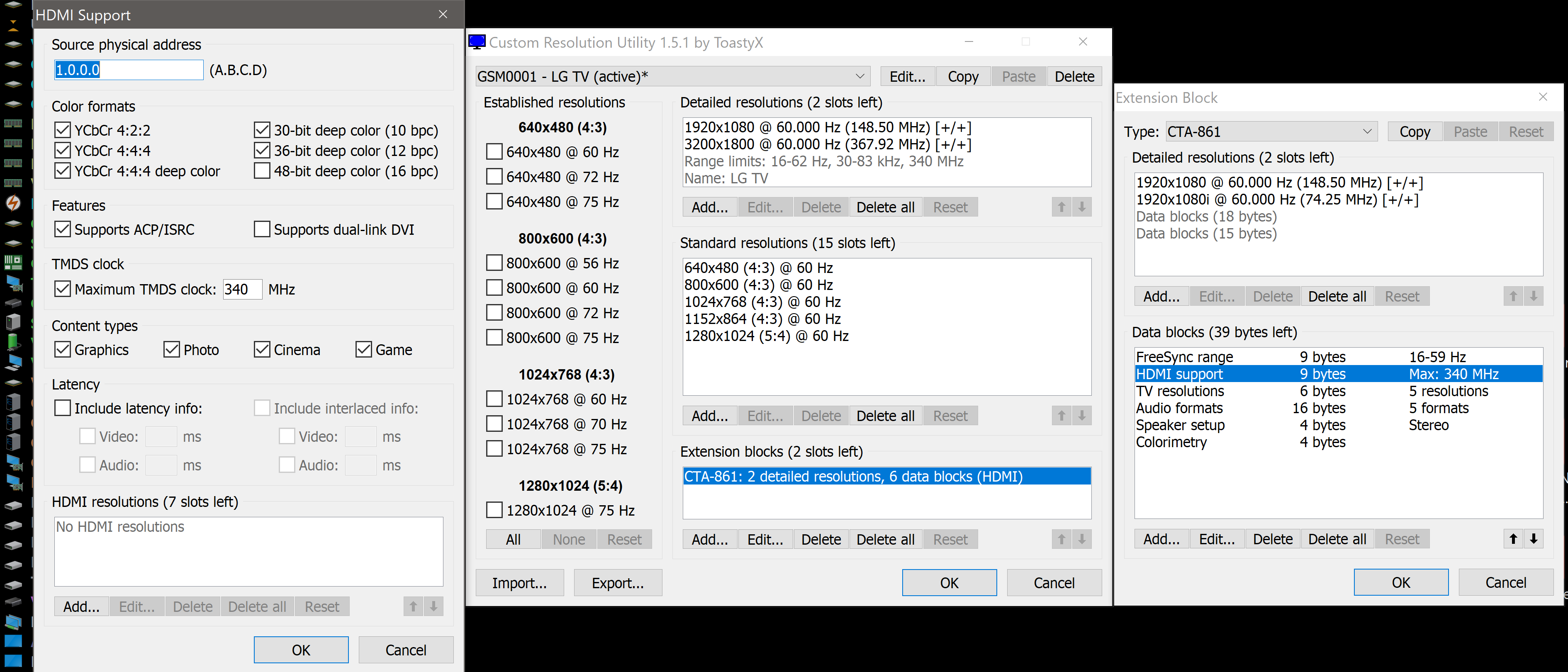

Hi ToastyX.
Thank you very much for your free software.
You gave a new life to my LG 32 TV from 2013, thank you.
I find your CRU program wonderful.
I have read a lot but one thing is not clear to me, I have an RX580 with HDMI 2.0 output, the HDMI cable is 2.1 and the TV is HDMI 1.4B.
The question is if I leave the TDMS at 340 if what commands is the limitation of the HDMI1.4B of the TV, or sends the HDMI 2.0 of the RX.
It lets me add the HDMI 2.x block and it doesn't give me a problem, but if I limit the 1.4b to 340, doesn't it make sense to set the TDMS to 600?
Thank you very much and greetings.
01-25-2021, 02:56 PM
Post: #5630
(01-25-2021 01:40 PM)dieg0 Wrote:  I have read a lot but one thing is not clear to me, I have an RX580 with HDMI 2.0 output, the HDMI cable is 2.1 and the TV is HDMI 1.4B.
The HDMI 1.4 spec doesn't support more than 340 MHz, and HDMI 2.0 uses the maximum character rate in the HDMI 2.0 data block, which is normally 600 Mcsc, so the maximum TMDS clock doesn't need to be set to 600 MHz. Changing the values only tells the driver what the TV supports. It doesn't send any commands to the hardware.
