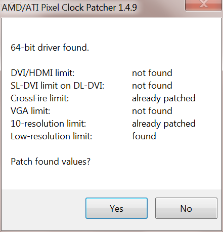

i have an inspiron 620 running windows 7 pro with an AMD RADEON HD 6450 Graphics Card which comes with a maximum resolution of 1920 x 1280. Is CRU the right thing to use if i want to connect this system to an LG um7300pua 4k smart tv? After running CRU will 3840x2160 be in the list of resolutions in windows display settings?

(02-22-2021 09:33 PM)teksport Wrote:  i have an inspiron 620 running windows 7 pro with an AMD RADEON HD 6450 Graphics Card which comes with a maximum resolution of 1920 x 1280. Is CRU the right thing to use if i want to connect this system to an LG um7300pua 4k smart tv? After running CRU will 3840x2160 be in the list of resolutions in windows display settings?
The TV already defines 3840x2160, so there's no point in using CRU.
You need the pixel clock patcher: https://www.monitortests.com/forum/Threa...ck-Patcher
You will only be able to get 3840x2160 @ 30 Hz with the patcher.
i ran it twice and got this
02-22-2021, 11:42 PM
Post: #5679
(02-22-2021 11:12 PM)teksport Wrote:  i ran it twice and got this
What driver version?

Driver Packaging Version 8.863-110628a-123368C-Dell
Provider ATI Technologies Inc.
2D Driver Version 8.01.01.1162
2D Driver File Path /REGISTRY/MACHINE/SYSTEM/ControlSet001/Control/CLASS/{4D36E968-E325-11CE-BFC1-08002BE10318}/0000
Direct3D Version 7.14.10.0841
OpenGL Version 6.14.10.10834
Catalyst Control Center Version 2011.0628.2340.40663
